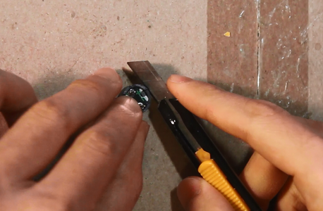

Step 3: Prepare the Coils
We'll start by turning our buzzers into our sustainer coils.
Using a sharp blade, carefully shave off the cover of the buzzer, by working the blade around the groove of the buzzer.
When we remove the cover, we'll find our coil inside, as well as a metal piece that's responsible for making the buzzer sound.
We don't want our coils to produce any sound, so we can simply throw this piece out or glue it on top of the coil (so that it won't vibrate but will protect the coil from damage).
