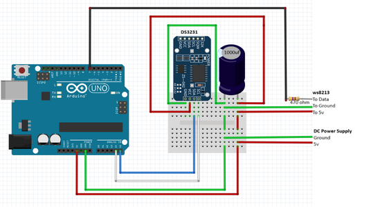

Step 3: Wiring the Project.
If you are using the ProtoType Shield put it on the Arduino.
The wiring is the most complex part of the project. I included pictures to help you see what I did. I recommend double checking all connections before powering on.
DS3231 - Real Time Clock Module
Put the DS3231 module in the breadboard and connect as in picture.
- Arduino Ground to GND
- Arduino 5V to VCC
- Arduino A4 to SDA
- Arduino A5 to SCL
In the picture I wire the 5v and Ground to thier own run on the breadboard because later we will want to attach external power.
Attach the WS2813 LED Strip
- arduino 5V to your 5V power.
- The middle two connectors are redundant data pins. they go to pin 7
- Make sure to put a 470 OHM resistor between the pin7 and two data leads.
- Arduino Ground to the last connector.
Attach the external 5V power supply (running the LED strip from the arduino power for long periods is not recommened).
- Put a 1000uf electrolytic capacitor between the leads.
- Connect power and ground to the Arduino Power (5V) and Ground (GND)
I don't recommend connecting the external power and USB to the Arduino at the same time.
