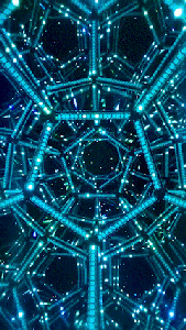

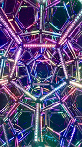

The infinity mirror features 510 individually addressable LEDs built in a dodecahedron shape. One way mirrors on the faces of the dodecahedron bounce the light from these LEDs around within the shape, creating an infinite space illusion within its walls. The lights can be coded with patterns of your choosing, such as flying comets, infinite stars, fireworks, colour pulses and many more.

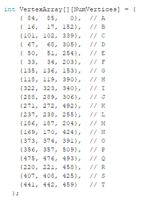

You need to initialise the FASTLED library at the very start of your code, after this you need to define the basic characteristics of your LED strips
#include <FastLED.h>
#define LEDsPerStrip 17
#define NumStrips 30
#define NumVertices 20
#define VertexConnections 3
#define NumLEDs (LEDsPerStrip * NumStrips
In your setup loop you need to configure your LEDs with the FASTLED functions, add this code:
FastLED.addLeds<WS2812B, LEDPin, GRB>(leds, NumLEDs);
The basic function for lighting up a given LED in the strip is given below:
leds[i] = CHSV(Hue,Saturation,Brightness);
Here you can denote your Hue, Saturation and Brightness values from a 0-255 range. Remember to include the ‘FastLED.show();’ to update the LEDs in each loop after your code has run.
For more complex patterns, it is important to reference the edge matrix. This matrix is used so that the code knows which strips are connected to each other in the LED loop, without this, a simple led running code will jump from one strip to another. You can use this matrix to check if the LED in your sequence is at the end of a strip, and pick an adjacent strip to jump to, making your comets travel around the shape seamlessly. The numbers in the matrix are LED numbers starting from 0, they are a direct reference to the layout diagram provided in step 3.

Once the mirrors are in place, you are finished! You can place the dodecahedron on its stand and turn on the power!
I find myself constantly gazing at my infinity mirror, and it’s very relaxing. Its patterns are continuously changing and never cease to disappoint! I had a lot of fun building this project, and I hope you will too. Leave a comment I you want me to make an Icosahedron version!
