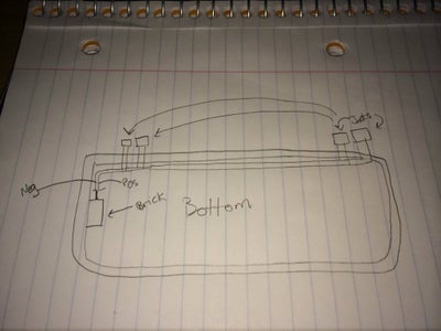

Step 2: Wire in the Power Wires
Flip the table over, and mount the power brick up on one end so that it is out of the way. I just drilled holes in the metal support that wraps around the table and used zip ties.( make sure when the legs fold they don't hit any of the wiring)
Now cut the wire a couple inches coming out of the brick. ( make sure its the part that leads to the barrel jack.)
Now solder in 2 wires, red for positive, black for negative, and extend them all the way down one side of the table.
Now branch off two sections for the barrel jacks on both ends. This is where the shrink tubing and heat gun came in handy. Electrical tape works just fine too. Just make sure all connections are covered so it doesn't short out. Sorry I don't have any pictures, but I have a crappy diagram that may help.
