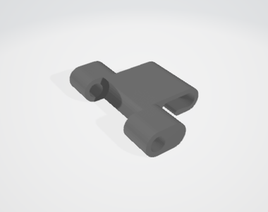

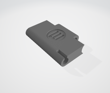

Step 1: Design in CAD
  • I use Fusion360 to design watch casing and strap.
  • i disassemble my old watch and use a watch machine in this project.

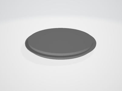

  • First I take all dimensions of the watch machine and design a case appropriate to hold that machine inside safely with bottom lead.
  • Inside the watch case I placed 6 circular places in 60 degree pacing for 6 Infinity stones.

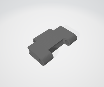

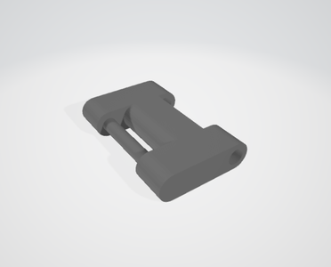

  • I design a strap Similar to a metal watch strap.
  • Also make a 3 circle on a strap for infinity stone side by side.

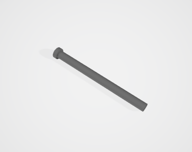

  • Make 3d printed pins to connect all straps and make it movable.

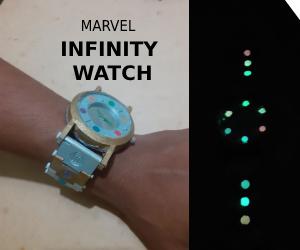

First place ring inside main case and assemble strap as per image.
Assemble all components and charge dark in glow material using UV light with sun rays.
It looks very cool and gives a nice effect of the Infinity stone on your hand.
