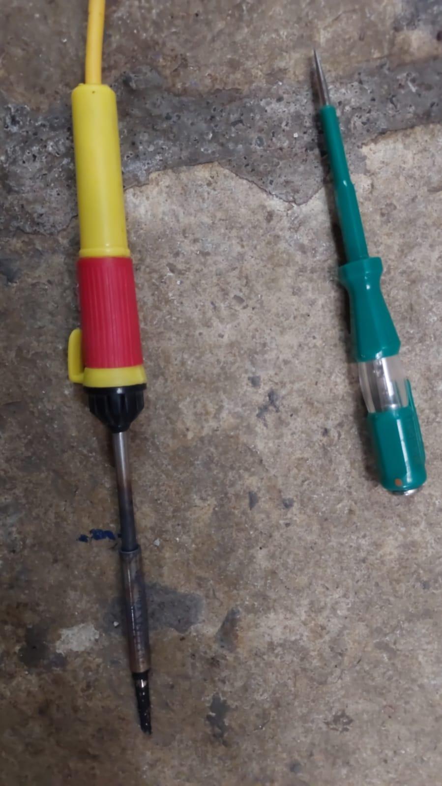

  7. Tester, Soldering Gun

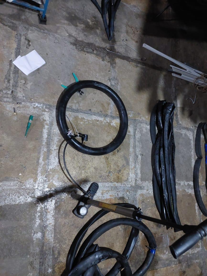

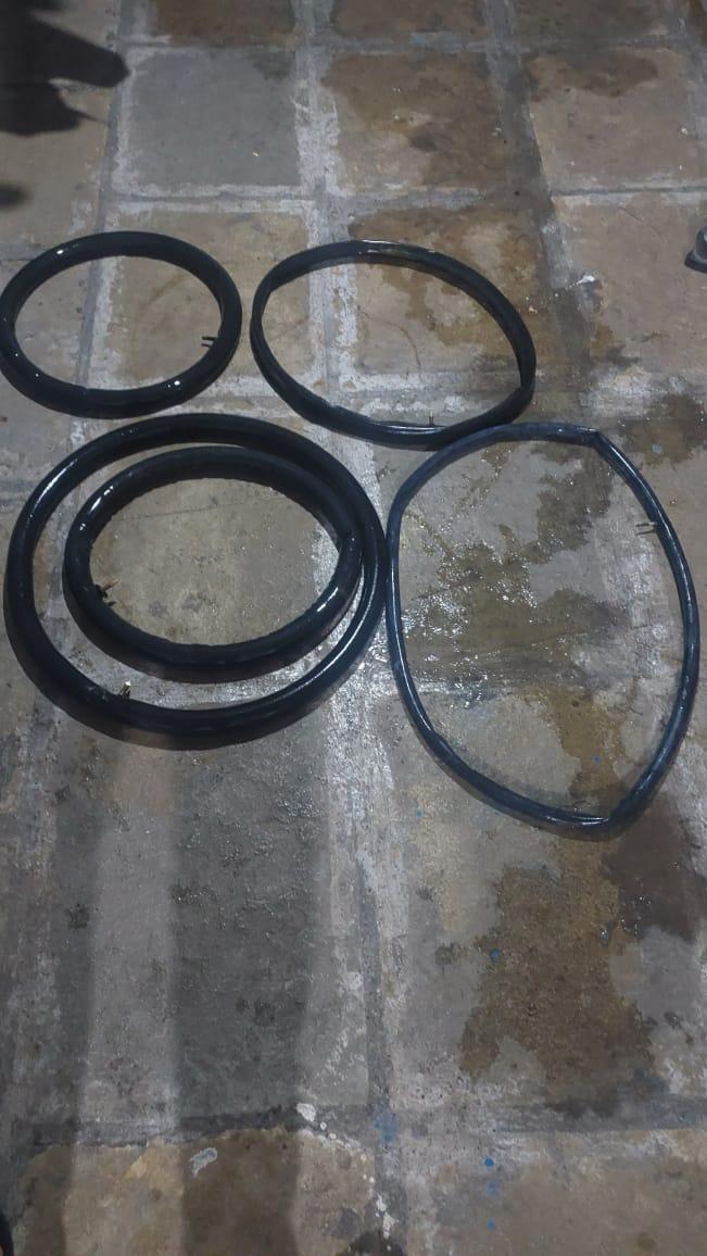

Step 4: Cleaning and Inspection of Tubes
As the tubes i took was from scrap, many were punchered and had small holes in it. For proper functioning I had to seal this holes with Punchure Patch and its Solution.
  1. I filled the tube with air using hand pump.
  2. i soaked the tube in water bucket to locate the puncture .
  3. The bubbles came out from place of punchure.
  4. Cleaned,dried and sanded the area near the puncture.
  5. Applied the puncture solution and then applied the patch to seal the puncture.
  6. Put some soapy solution on tube to check if it was sealed properly.

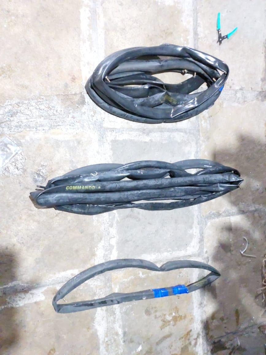

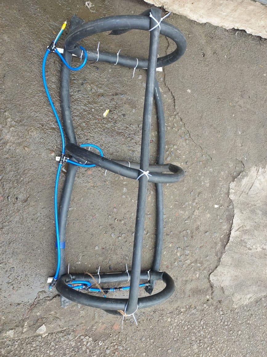

Step 5: Attaching Tube to the Strip
  1. I cut 600mm long Conceller strip as a base for this tubes
  2. Repeated the same to cut total of 3 pieces
  3. Pressed the tubes towards the concealer strip until it reached the both end of strip. Pressure in Tube at this time is low (10PSI)
  4. Secured it with 4 Cable tie (Two at opposite ends and 2 in middle)
  5. Put some instant glue to make it fixed.
  6. Repeat the steps for other 2 tubes.
  7. Attached T joint and Pnuematic Connection to it. (REFER starting Concept Diagram for Pneumatic connections)

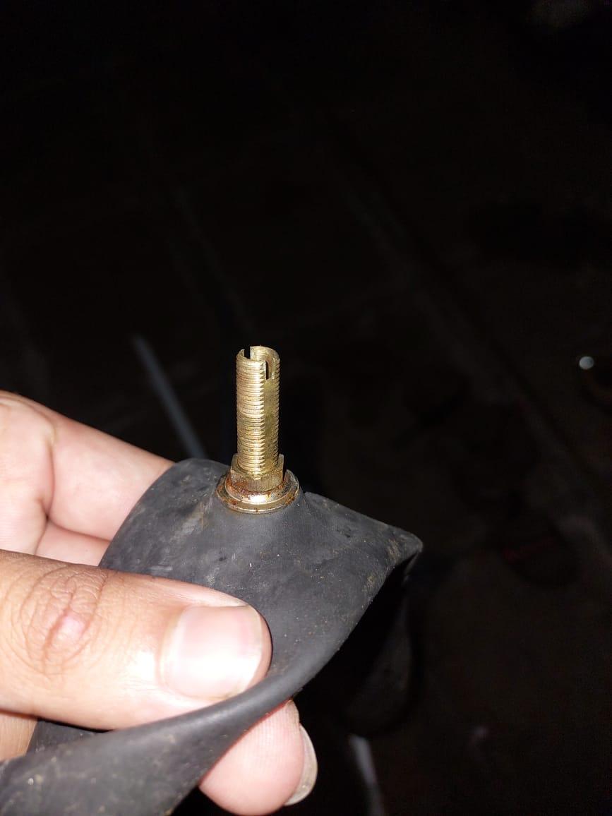

Step 6: Making 1 Way Valve for Inlet
  1. I removed the valve from one tube.
  2. Cut the head like structure using hacksaw.
  3. Attached the assembly to the pneumatic pipe.
  4. Later sealed with M seal for leak proofing.
  5. With this the air won't escape from the shelter from the inlet.
Step 7: Install the Horizontal Tubes of the Structure
For making Horizontal tubes. I cut the tube and thus it became linear. I sealed both the ends of the tube with m-seal. Here I also tried many other alternatives like Rubber based adhesive, Punchure solution and Hardner expoxy. But M-seal worked the best for me. If anyone in community finds a better option, please suggest it in comments.
Checked if there are any leakages at the sealed ends of the tubes.
Firstly I planned to install 5 horizontal tubes for support of tent, But later on decided to use 3 tubes for the prototype.
I used instant glue to fix it on concealer patti.
I used 6 T joints and 2 straight joints. If you cut the pipe properly you wont need the straight joints. The Basic structure of the the shelter is now ready.

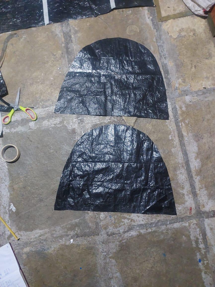

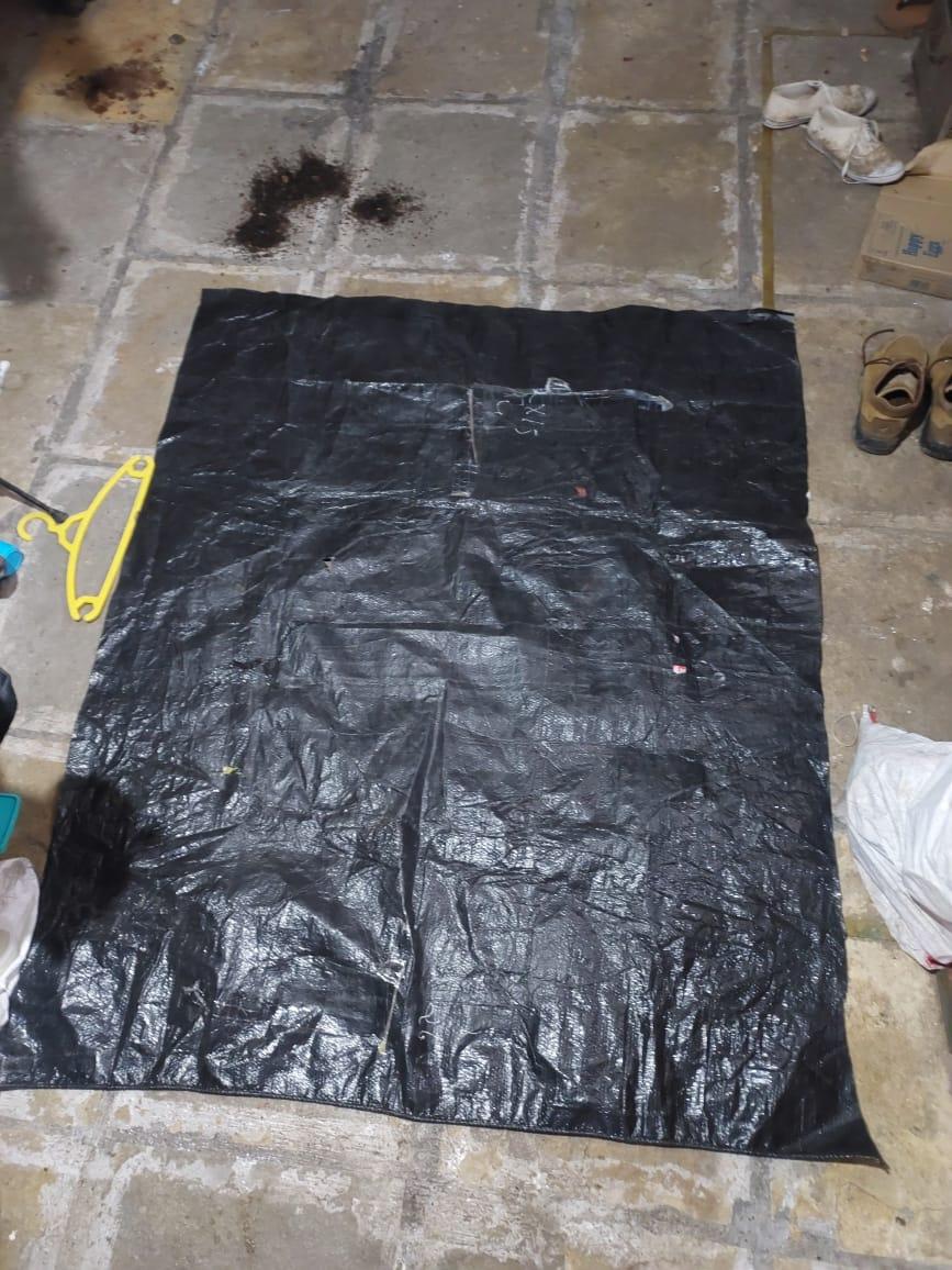

Step 8: Outer Tent Making
Firstly i took dimensions of the infaltted shelter of front face , Back face and the length of the shelter. Added 10% to every dimension of shelter when cutting on tarp paper.
Now made an Semcircular outline on the Tarp paper using masking tape. I also made outline for the transparent area and doors.
  1. For front I had two doors, one for entry and other for exit. I also had to add some transparent medium which would allow light to come in shelter in daytime
  2. For back I made it fully closed.
  3. For Center portion I calculated perimeter of the semicircle and cut out an rectangle with width of perimeter and length of the shelter.
The Shelter is semetric so the cutting was also semmtric .
Joined all the tarp pieces to the Shelter tubes using Instant glue.
