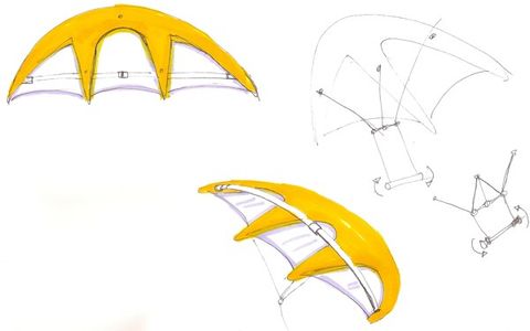

Step 2: Design It
The second thing in inflatable design come from the process; The sheets (the second material to get PVC sheets that comes in all colors and flavors) are putted one over another (like sewing) so you are restricted to work with 2D shapes but thanks to the air this 2 sheets into cool 3D shapes, even welding in different planes you can make almost everything in an inflatable version. As example look welding lines of a swim ring two sheets are welded in a form of two concentric circles 2D that inflated transform in an 3D torus.
Third tings based on experience: use rounds in your design, make big things and the most important iterate; the most cool and sometimes headache things about inflatables at the beginning, is that when you try something new you will never know what 3D shape is going to take by blowing air into.
So basically that it is talking about design, you need to plan everything, make many ideas, if you don't want to spend a lot on samples.
The design of this kite is made using a vector program like inkscape, Even free plans of kites could work just think about the inflatable zones, the valve and hangers; is just the front view of the kite traced with double line as easy follow guide for welding.
some 3d rendering in Creo parametric for good show (not necessary step)
