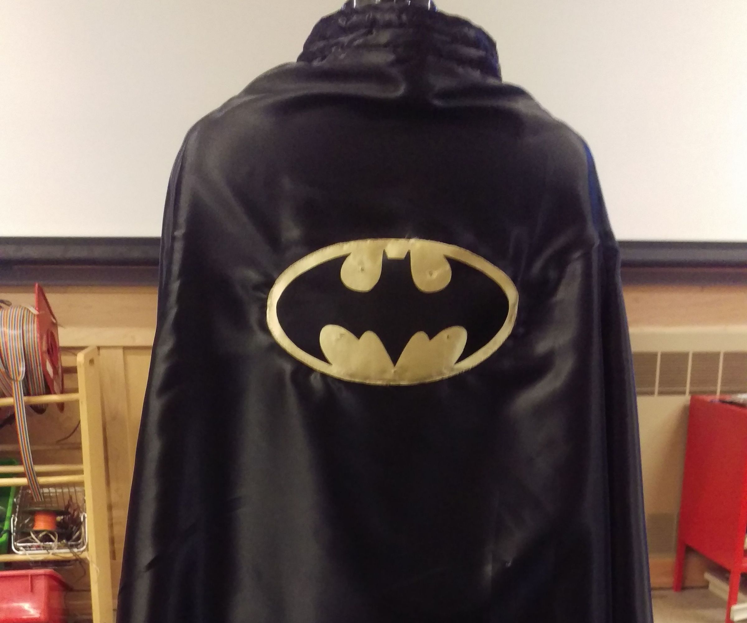

Here is another idea and an example that you really can make these in any shape!
