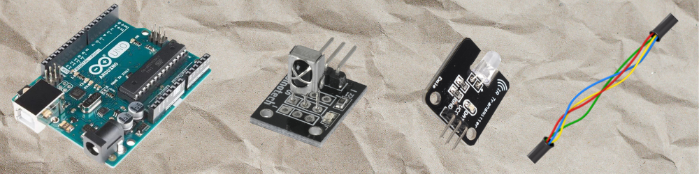

We will be using an Arduino Uno, an emitter board, a receiver board, and some cable for the wiring. Bear in mind you can just use a simple emitter and receiver but you will have to add the required components to make it possible. In the case of the emitter, you can plug in directly the LED in pin 13 since Arduino has a resistor incorporated on that pin. please take a look at this publication:
IR emitter
Step 1: Connections
As you can see with this little board connections have no mystery. Both boards work with 5v so if you want them to be connected at the same time, you will have to use a breadboard. to feed the positive line and connect both boards. Or you can just simply take turns to clone and emit.
