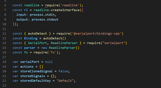

Step 3: Code / Imports
As you can see we will be using libraries we used in previous tutorials, I recommend you to take a look at those.
Like the one related to serial port, for example. But we added new ones like readLine or readLineParse. The last one is included in the serialPort library.
You will also see the variables declaration required for all the functionalities this simple code provides.

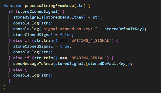

Step 5: Code / Reading Messages From Arduino
This function processes the incoming strings from the board. Depending on the different states of the program: it stores the signal in an array, prepares to receive the signal from the receiver IR board, sends the stored signal to the board once is ready, and prints the string as a default in the if-else statement, respectively.

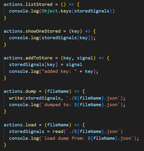

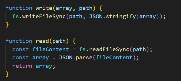

Step 8: Code / Storing and Retrieving Signals to a File
These utility functions help us to write and read files to the folder in which the NodeJS code is located. Files containing the array with the different cloned signals in JSON format:
"signalName":"1252,420,1256,424,1252,......1260,412,424,1256,420&"
You will be able to provide the name of the file. So in this line, you will be able to clone signals of different devices and store them in a specific file. And of course, retrieve it later.

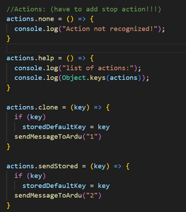

Step 9: Code / Defining Actions
Finally, here you have all the possible actions. As you can see actions is an array containing functions. In this way, you can write actions with no limit. As mentioned in previous tutorials you can even have a separate file containing only functions, and import them as a library. I like this way of programming cause is very neat and scalable.
