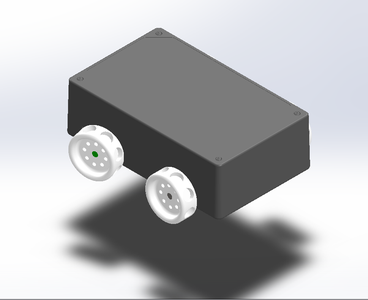

Step 2: CAD Models, 3d Printing and Laser Cutting
First figure out what you want your car to be capable of. You can do whatever you want with it, provided you keep in mind the range of the IR remote you decide to use if you stick with IR. This is important for materials selection as well as design considerations.
Next design your car using a 3D CAD software, I used SolidWorks, but you can use any 3D CAD software (Autodesk Inventor is free for students if you need something cheap). You will need at least to model all of the components you plan on 3d printing (unless you can find what you need on GrabCAD or similar site), it is helpful to model the entirety of the car to make sure it functions properly before using materials.
If you plan on making your own gear system you will need to model them in a 2D sketch software as well (for the laser cutter). I cut mine out of acrylic because I could get a pretty large sheet of it for $20 but you can use wood or even metal if you’d prefer, just make sure the gears are accurately spaced and will mesh properly.
