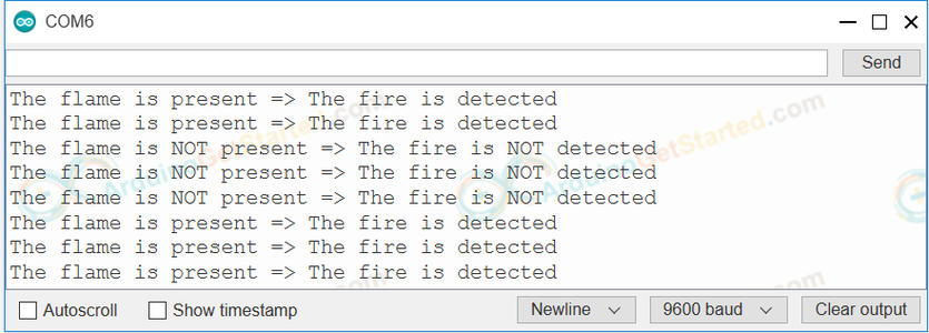

  • Direct the flame sensor to a flame.
  • See the result on Serial Monitor.
Step 3: Working
The working model of the fire detector allows us to observe the output in the serial monitor and the buzzer. When there is no flame or fire, there is no sound in the buzzer, and it is printed as "The fire is not detected." Conversely, when there is fire or flame, the buzzer emits a sound, and it is printed as "The fire is detected." This demonstrates the functionality of the fire detector in detecting the presence or absence of fire.
