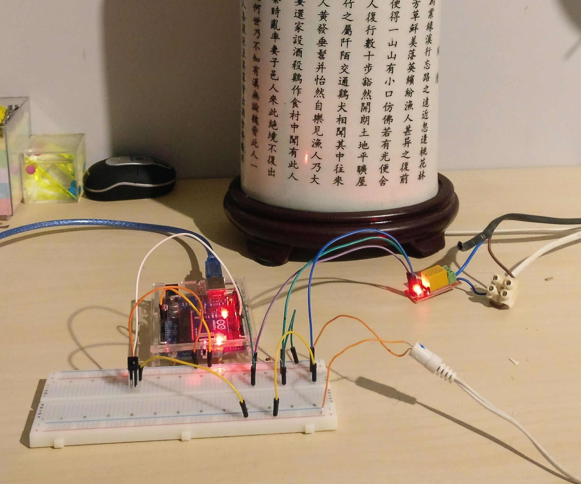

Step 1: Build the Circuit
Since this is a simple circuit, start by building it. Looking at the circuit, we notice it only has one component, the IR decoder. The IR decoder, like many components, is simply a bunch of parts combined into one. In the image above, you can see that the IR decoder has a demodulator, which turns the messy square wave output into complete 5V pulses. In the third image, you can see the wave signal that the Arduino will receive.There are complex protocols and identification procedures in place that turn simple pulses into actual binary digits.
The IR decoder has 3 pins, one for GND, one for VCC and another one for the signal output. Your Arduino microcontroller is responsible for reading the signals coming from it. Therefore your code must also reflect this and constantly scan for signals. Precision is of the essence; if you miss one signal the entire message could be misinterpreted or even not read at all. To ensure accuracy, use a library that has been extensively tested in your code.
Note: I'm using a TSOP4838 IR decoder - depending on which one you have the pin layout might be different. Always double check!
Obtain the datasheet for the component here.
