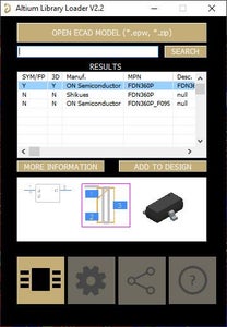

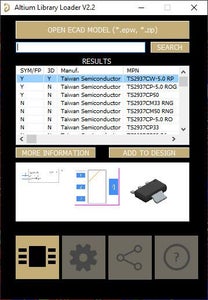

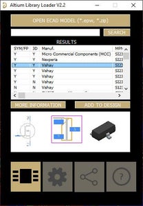

Specifically, I used the SamacSys libraries for IC1 [9], IC2 [10], REG1[11], Q1…Q3[12], and Q4 [13], which you can consider the links in the references. Another option is to download the component libraries from componentsearchengine.com and import them manually. It’s up to you. Figure 4 shows the selected components in the SamacSys Altium plugin.
Step 5: Figure 4 Selected Component Libraries in the SamacSys Altium Plugin

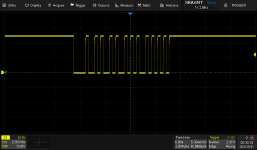

I have tested the output of the VS1838 module using the Siglent SDS2102X Plus oscilloscope [16] (figure 6). You can use other models as well, such as SDS1104X-E [17]. The oscilloscope screen says that the signal is clear and noise-free. Each remote control manufacturer might use an existing or its own infrared protocol and each remote key generates a different code, so the output signal of your remote could be different. I used a SONY HDTV remote control which naturally uses the SONY infrared protocol.
Step 9: Figure 6 the Output Signal of the Infrared Receiver Module (U1)
After successful programming of the microcontroller, please disconnect the programmer and restart the board (disconnect and re-connect the power). Then you can store the desired remote control keys (by pressing and holding the SW1). You can change any of the stored keys any time later. The keys are stored in the EEPROM memory, so the power reset does not clear the memory and the stored keys. For more details, please carefully watch the YouTube video.

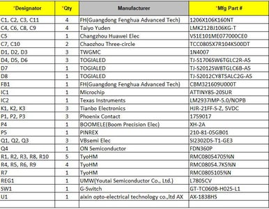

Figure 7 shows the bill of materials.
Step 10: Figure 7 Bill of Materials
