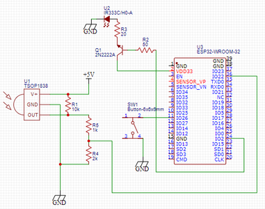

There are many variants of the ESP32 - each with its own pinout! This complicates the process of designing and sharing circuits for it. I used the ESP32-WROOM-32 module but any ESP32 will work - just be careful to use the pinout of your own device. The ESP32 in the circuit above has a different pinout that my development board.
The ESP32 uses 3.3V logic but the 1838T works best with 5V. The 1838T receiver should be hooked up to ground and 5V (the Vin pin is connected to the 5V from the USB cable, so I used that). A 10k pullup resistor is used on the receiver's output to prevent the pin from floating (which would be perceived by the device as a received code). This output should then be connected to a potential divider to provide 3.3V to the ESP32 GPIO 22 (any input pin would work).
In the IR receiver datasheet, the device has a maximum peak current rating of 100mA. As the codes are sent in short pulses, the LED is only on for a fraction of a second at a time. This means it can draw a higher current than normal without burning out. The more current through the device the brighter the light output and therefore the longer the range of the device. I decided to let 60mA of current flow through the LED as this value provides a good range without running the LED at too high a current. I got a range of 4.2m with this design.
Each IO pin on the ESP32 only has a max current draw of 12mA which would result in a shorter range if used directly. To overcome this, I used a NPN transistor which allowed GPIO 22 to control the flow of current from the 3.3V pin (which can source more current).
I also added a button which is used to enable the receiver in software. This prevents background noise from being recorded as a signal which would then be saved by the app.

When you finish assembling the project, test it to ensure all the connections are right and the components aren't defective (I've had many low-quality receivers malfunction so that they appear to be receiving random commands constantly). Sunlight can sometimes be perceived as a command by the receiver, so the button is a vital addition to prevent random noise being saved as a code.

The Infrared LED can also break. The circuit deliberately pulses a high current through the LED to achieve a longer range. If the circuit isn't connected correctly (for example during testing) prolonged exposure to this current could damage the component - just like a regular LED. As we cannot see infrared radiation with the naked eye, it is harder to diagnose the problem. Luckily, the camera in your phone can see IR.
