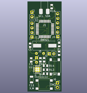

In that way, I made a PCB that integrates an Atmega 328P (same controller as the Arduino Uno/Nano) to control inputs and outputs from buttons and sensors. In its simplest expression, it's an Ir sensor that reads temperature. What makes the ThermoPen different and original from this basic concept is that it includes features extremely useful for the user, in a small and slim form factor.

Step 2: Design the Schematics and the PCB
As I said earlier, the schematic takes inspiration from the Arduino Nano for the Atmega328P circuit including its power circuits and clock choices. For convenience, I took a crystal generating a lower frequency, as it would enhance batter efficiency. The Oled screen, buzzer, IR sensor, and laser diode are connected to the micro-controller, via Analog pin, Digital pin, or from I2C communication bus. For the circuit related to the charging and discharging of the Li-Ion battery, I took some serious inspiration from an Adafruit Arduino Uno shield for a rechargeable battery.
Here's a link the to product:
https://learn.adafruit.com/adafruit-powerboost-500...
Thanks, Lady Ada for your awesome work!
Everything was done using KiCad and some libraries provided by DigiKey, a big electronic parts retailer. You will find the complete KiCad project in the ThermoPen GitHub.
I used KiCad for Schematics design, as well as PCB design. It's a really powerful software for an open-source project, and it's free.

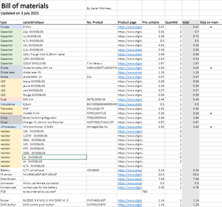

Step 3: Shopping and Ordering Electronics Parts
During PCB design, I also took time to select the right electronics parts that fitted my use case. For example, I had to select a small package size so it would fit inside a small enclosure. Most resistors and capacitors are 08x05 package size.
I was lucky enough to have some of those parts in possession, at school, like SMD button and the IR sensor. For all the other parts, I ordered them from Digikey, one of the biggest electronics part retailers in North America. For convenience purposes, I made an Excel list of each component needed, with their price and store link.
The list is accessible from the ThermoPen Github!

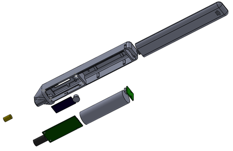

Step 4: Product Design and 3D Render
Now comes the challenging part: Integrating everything in a small and practical case!
The 3D design was done using Solidworks.
To make my life easier, I modeled all the parts I knew the dimension, like the battery, the USB connector, the PCB, the diode laser, and the infrared sensor.
I decided to choose a squared shape, so I could easily pass wire around the battery or other components. I wanted the tolerance to be very tight, so no screws would be used. As a result, the battery clips very nicely in the casing, as well as the PCB. For the button, I made a clever design that integrates an aluminum button that is squeezed between the PCB button on the plastic housing.
The laser diode is placed just between the IR sensor for maximum accuracy. When the product is in the hand, the laser is hidden behind the point of the pen. It's a more elegant way to integrate the laser because it seems to the user that the laser comes from the IR sensor, but it's not.
On the main side of the pen, I placed the Oled screen next to the button and the ThermoPen Branding at the other end. On one side, there are two holes for the charging indicator LED, which indicate when the battery is charging and fully charged.
As you see, the inside is accessible by a sliding cover dissimulated at the backside of the pen. It stays in place by a plastic bracket. The assembly is done on this side and is also used for battery replacement.
During the design process, I needed to keep in mind that the housing would be 3D printed in plastic, so I tried my best to avoid floating pieces.
It was one of my first product design experiences and I enjoyed doing it. I think I came out with a design workable for the first prototype. For sure, I ended up printing the case multiple times, each time slightly modifying the precedent design.

Step 6: Soldering of the PCB
One of the greatest challenges of the project was to solder every part without any failure, as the PCB contained more than 50 parts that required different soldering techniques and equipment.
Firstly, I designed the PCB so all components that requires a reflow oven are located on the same side. It was the case for the Atmaga 32P, as well as the buck-boost circuit that converts 3.7V from the battery to 5V for the micro-controller. For better tin application, I used an electronic magnifying glass with a Timed Air Dispenser filled with tin.
The buck-boost chip caused me some serious trouble, as all of its pads were underneath the package type. As a result, my first soldered PCB got burned because of a short circuit caused by this chip. It to me some time to find the problem, which caused me to reconsider the quality of the electrical wiring. Fortunately, I fixed this problem by soldering a new PCB and from now on the circuit seemed to react normally when powered.
You will notice that the PCB includes lots of connector holes. This is where the wires for different components located outside the PCB will be soldered on the assembly step.
Some parts and PCB footprints changed since this prototype, like the inductance footprint, as I only got one chance to develop and manufacture a PCB during my project deadline. Since then, I did various little tweaks and also added a diode preventing reverse battery condition.

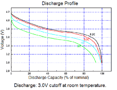

For the battery icon, I used the infamous Microsoft Paint to design quite basic icons that fit a low-resolution screen. For a certain battery voltage range, it would print the icon corresponding to the battery voltage. However, I still consider the battery icon a "work and progress", as I didn't verify which battery percentage corresponds to which battery voltage. To be clear, a Li-Ion battery has a specific battery voltage discharge curve and it's not a straight line!
