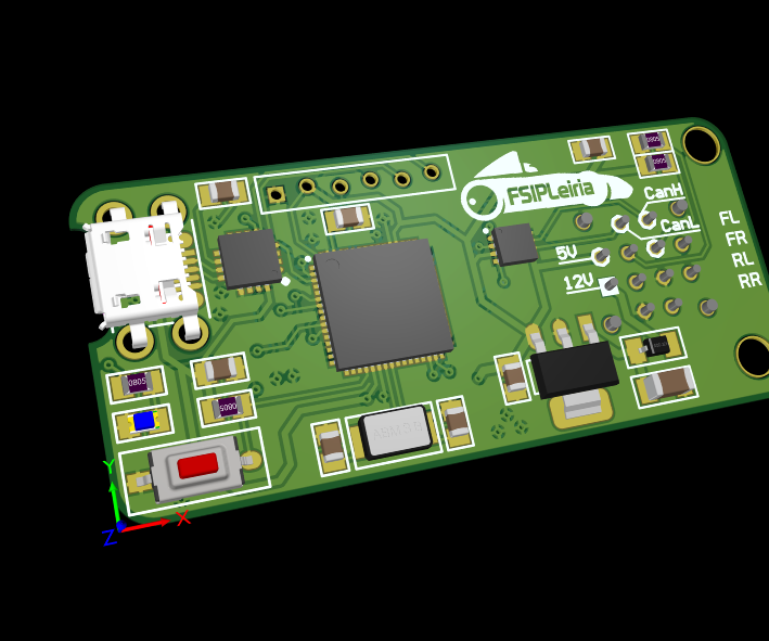

Step 3: Design PCB
Taking intoaccount the application of this module, since it is to be implemented next to the wheel of the car, there was a need to develop the PCB with the smallest possible dimensions. For this purpose, very small sizes were defined for the thickness of the PCB tracks and tracks in order to save space and the components were positioned so as to minimize the free space on the PCB. As a final result, the PCB shown in the figure of dimensions 48x12 mm was obtained.

Step 5: Assembly
As the last step of this process, after receiving the PCBs sent by the manufacturers and gathering all the necessary components, the final assembly of the modules for implementation in the car was carried out, as shown in the figure.
