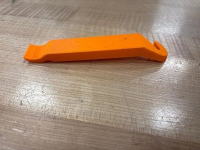

The first step I personally took was brainstorming different potential designs. I created a concept sketch as seen in image 2 in order to being to lay out the general design and to have a general idea when beginning to design a model in cad. I then 3d printed out several different bike tire levers, one such example is seen in image 1, in order to determine the final design I wanted to go with. I recommend 3d printing out many different designs when designing your own mold as 3d printing is much easier and less costly than the final machining. While brainstorm a design its important to keep in mind that the more overhangs and complex geometry you have the harder it will be to machine out the final mold and it might be entirely impossible depending on the model. In my case I used the prototype on my own bike and it worked well so I moved to the design of the model in fusion 360.

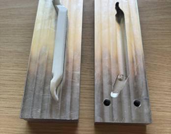

This step was relatively simple aside for one of the programs failing at the end. I used four different nc programs to cut out the two sides. I first cut the the mold for the top side using a 1/2in endmill, 1/8in endmill, and a 1/8in ballendmill. I then ran the program for the top of the top side of the mold which cut out the space for the bushing(image 1). I then cut the other side of the mold using the same tools. The only problem I encountered happened when I tried running the program that would drill holes into the top half of the stock. Despite being the exact same NC program as the previous one except for not running the facing or clearing operations for some reason the mill used a wrong tool and when the mill attempted to drill the end mill broke. I tried again this time making sure that the mill used the correct part however unfortunately the drill despite working fine on the previous operation broke again perhaps due to the fact it was drilling the same spot where the previous tool broke. Despite this the rest of the machining turned out great.
Step 5: Assembly
While the molds both fit each other perfectly due to an issue when machining the holes on the top half of the mill the drill broke and I was unable to complete the threads in the top half of the mold due to time constraints. A photo attached above however shows the bottom half of the mold which turned out perfectly. If I had not had an issue while drilling the holes on the top half the molds would line up perfectly. When I finish the project next fall all i'll have to do is drill the last 4 holes and then thread the two pieces together. The assembly is incredibly simple and only contains three parts in total as shown in the picture above.
