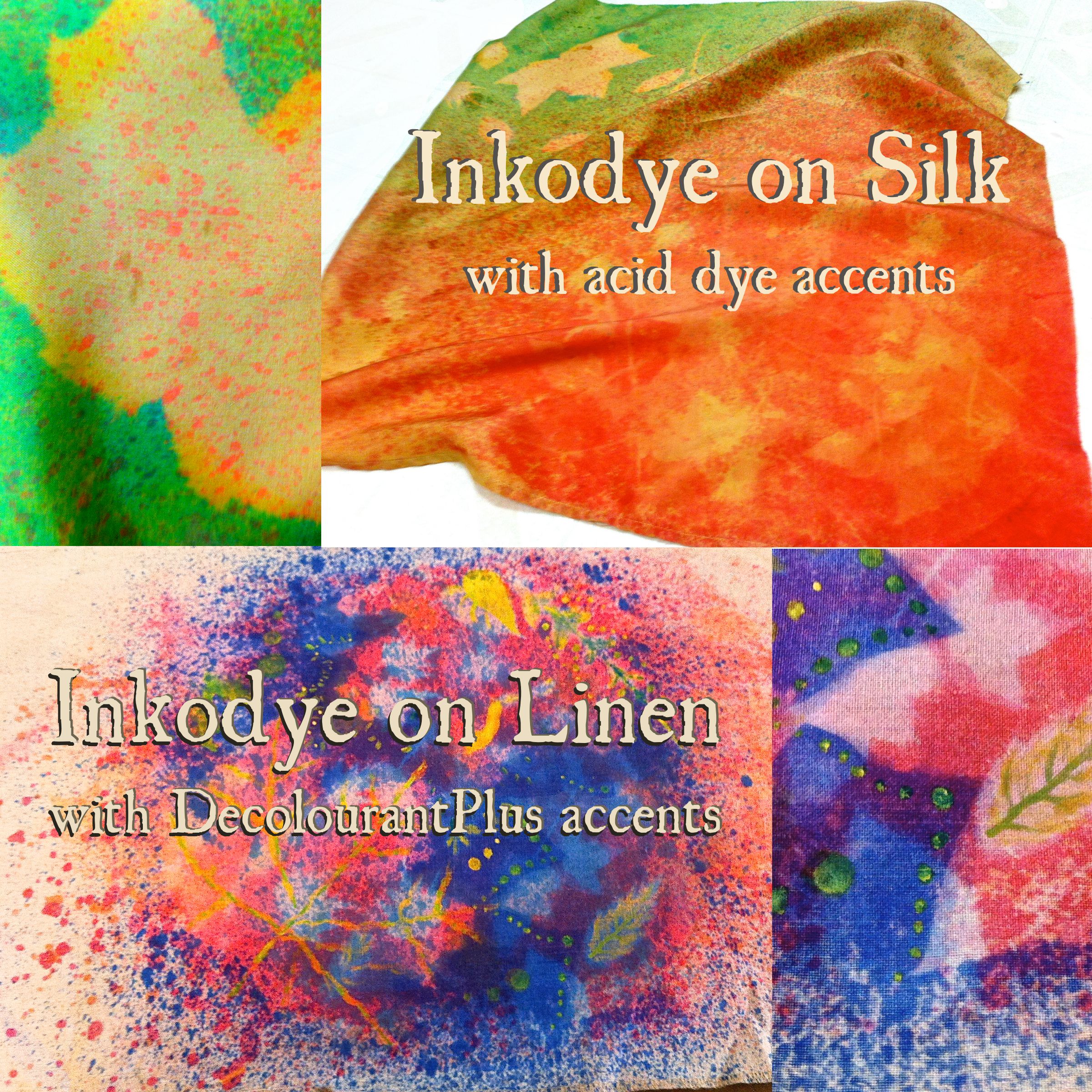

Another note about blue Inkodye: it can produce beautiful, intensely dark images. It's also tough to wash all of the unexposed dye out of fabric.
Suggestion: agitate like my brother in elementary school without his adderall. Seriously. Scrub the fabric by hand as if your life depends on it, using the proper amount of Inkowash detergent. This is also apparent in our first instructable when the blue splatters under the leaves showed up later.
