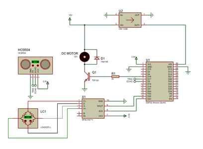

Step 2: Create a PCB With All the Electronic Components
To avoid false contacts and improve system organization, it's best to group all components together on a printed circuit board (PCB). The main components are soldered to it, and connectors are added for the motor and scale cables, which are a little further away from the rest of the electronics.
NB: Refer to the diagram for exact routing and placement.
