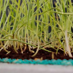

Step 6: Seeds Sprouting Into Seedlings
  • And the seedlings develop their first true leaves in 10 days.
  • Cut them out if they are too crowded.

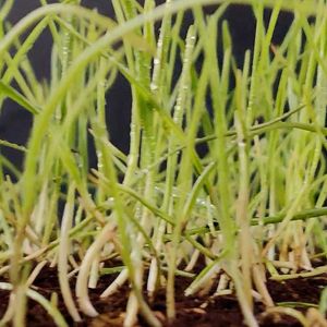

Step 7: Removing the Roots of Your Seedlings Carefully
  •  Carefully lift the seedlings from the growing medium, supporting the base of the plant to avoid pulling on the stems or the roots.
  • Use a knife to cut between the mosquito nets, this will separate the roots from the greens.
  • Once the roots are separated you can use them for different purposes.
