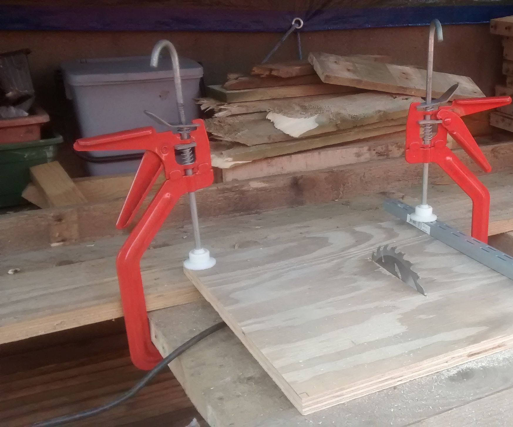

- A pile of clamps (the orange type pictured are my favourite, I find the "quick clamp" type much less stable)
- A way to cut angles (mitre saw pictured, I also used a small band saw because I'm lazy)
