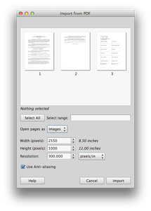

Step 1: Convert the Pages in the PDF to Separate TIFF Files
Convert the pages in the PDF to separate TIFF files. I did this with the free GIMP program. It runs on just about any operating system, so that shouldn’t be a problem. GIMP gives you several options for importing the PDF pages. Be sure to adjust the resolution to something like 300 dpi and select Open pages as images. Unless of course you love layers and know exactly what you’re doing. Warning! If you go for a default resolution of 100 dpi, you might lose some quality. Don’t worry if you get gigantic TIFF files. They’ll be compressed back later.

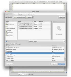

Step 2: Add the Image You Want to Insert to the Appropriate TIFF File(s)
Within GIMP edit the page you want to insert something into. If you can’t work with GIMP, edit the appropriate TIFF in your favorite image editing program. Either way, you should end up with a separate TIFF for every page in your PDF. Exporting to TIFF in GIMP is easy if you know how. File – Export As… and then Select File Type (TIFF Image). Check if your TIFFs are all beautiful. They should have increasing names, like page01.tif, page02.tif, etc.
