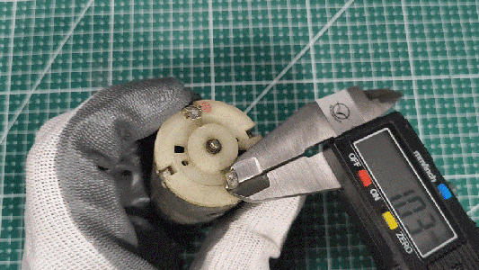

  1. 12V DC Motor: "This was my primary reference. I needed the real object in hand to check angles, clearances, and the exact dimensions of components that are often missing from standard datasheets."
  2. Digital Vernier Caliper: "This tool was essential for precision. I used the caliper to measure every single part, the shaft diameter, the thickness of the housing, and the width of the magnets ensuring the digital model was a perfect mechanical replica."
  3. PC with Fusion 360: "This was the digital studio. Fusion 360 allowed me to model the geometry parametrically, but more importantly, it let me choreograph the animation and generate the final cinematic renders."
Step 1: Measuring and Reverse Engineering
Before opening Fusion 360, I needed a plan. I took the physical 12V motor and measured every critical dimension using the digital vernier calipers.
I measured the shaft diameter, the outer casing length, and the distance between the mounting holes. I sketched a rough diagram in my notebook and noted down all these values. Creating this 'cheat sheet' first was important, it meant that once I started 3D modeling, I could just type in the numbers without having to stop and measure the motor every two minutes.

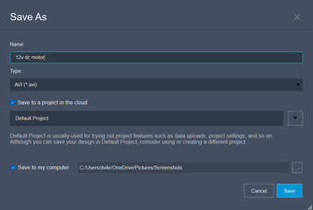

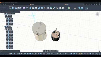

Step 7: Bringing It to Life (The Animation)
This was the most challenging part of the project because it was my first time ever using the Animation Workspace in Fusion 360.
1. The Learning Curve: Since I was new to this, I spent time watching 'The Fusion Essentials' YouTube channel tutorials to understand the basics. I learned that animation isn't just about moving parts; it’s about timing.
2. The Explosion Strategy: I used the 'Transform Components' tool to manually grab each part of the motor.
  1. I didn't use the automatic 'Auto-Explode' button because it looked too messy.
  2. Instead, I manually pulled the Stator Housing to the left and the Rotor Shaft to the right along the y-axis.
  3. I dragged the End Cap, rotor and magnets.
3. The Timeline: The secret was in the timeline at the side of the screen. I adjusted the bars so that the End cap moves first, and then just a split second later—the rotor and magnet float out. This slight delay (staggering) made the animation feel elegant, rather than just snapping apart instantly."
Step 8: The Result
Here the scene; Suddenly, the machine opens up. The internal components—the plastic enclosure, the curved magnets, and the complex rotor—slide out smoothly along the Y-axis. It looks as if the motor is being "gutted," leaving the hollow shell behind.
the internal mechanism hovers outside its casing, allowing the viewer to inspect the delicate parts usually hidden by steel.
