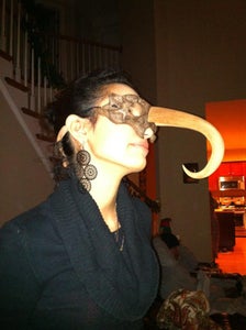

Step 10: Done!
Congratulations, you have finished your wooden mask! Mine was inspired by the plague doctors of old with a flair of venetian fashion thrown into the mix, but have fun with them!
Enjoy!
