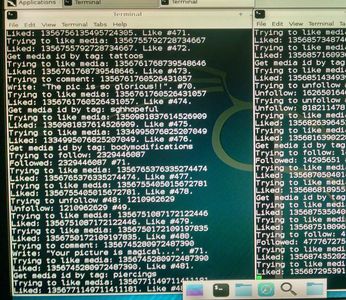

Step 3: Run. (Go)
After you finish setting up the things I mentioned earlier, you are ready to go.
get into the directory and type
$ python3 example.py
if you have another version of python or a different file name use that.
Image attached is running same scripts for 2 instagram accounts to reach to more audience.
