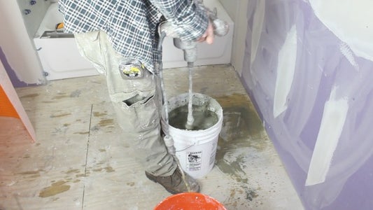

Step 3: Mix Modified Thin-Set
Once your subfloor is good to go it’s time to install the DITRA.
Mix up modified thin-set.
Thin-set should be mixed to a fairly fluid consistency.
BUT should still hold a notch.

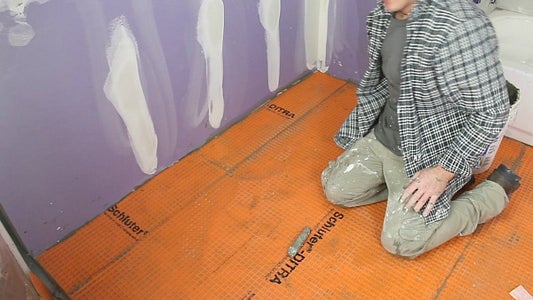

Step 5: Dry Fit DITRA
Dry fit the DITRA on your wood subfloor.

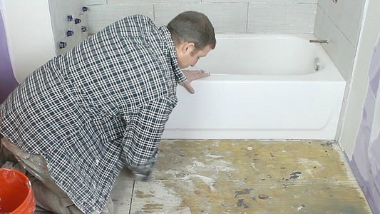

Step 6: Clean & Dampen Wood Subfloor
Clean and dampen the wood subfloor.
This creates a solid bond between the thin-set and DITRA.

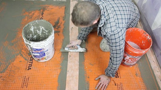

Step 7: Apply Modified Thin-Set
What trowel should you use to apply thin-set to the wood subfloor?
Check it out, we’ve got you covered
- 1/4″ x 3/16″ V-notched or
- 5/16″ x 5/16″ V-notched trowel or
- DITRA trowel which features a 11/64″ x 11/64″ square-notched design
How’s that for detail!!

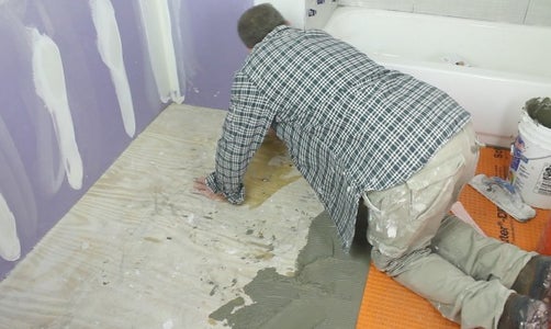

Apply the modified thin-set to the wood subfloor.
Notches should all run in the same direction.
Step 8: Embed DITRA Into Thin-Set
Embed the fleece side of the DITRA in the thin-set.
Leave a 1/4″ gap between walls and the bathtub.
Use a rubber grout float to push the DITRA into the thin-set
Step 9: Check Thin-Set Coverage
Lift up a corner of the DITRA to check for thin-set coverage.
Your goal should be 100% coverage…we had a few bare spots here and fixed that issue!!

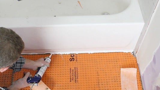

Step 15: Fill Gap Between Tub and DITRA
One of the worst spots for water damage is where your tub meets the tile floor.
Fill the 1/4 inch gap between the DITRA and tub with KERDI-FIX.
Step 16: Embed KERDI-BAND
Fill in the cavities with unmodified thin-set and embed the 5 inch wide KERDI-BAND
