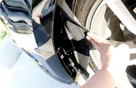

Step 1: Gain Access to the Back of Your Stock Parking Lights.

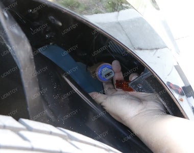

Remove some screws holding the wheel well liners and peel it back.

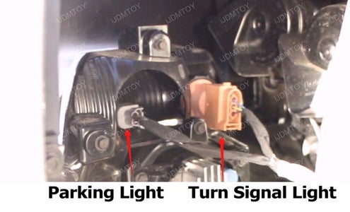

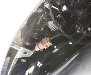

Step 2: Unplug the Parking and Turn Signal Harnesses.
Remove the OEM turn signal light bulbs from its sockets.

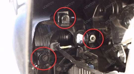

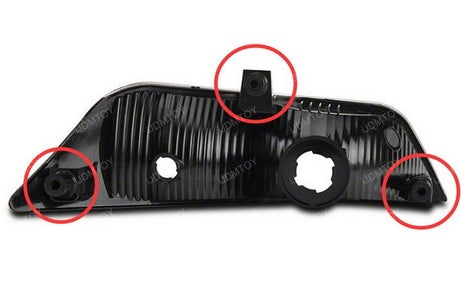

Step 3: Take Out the Screws on Your Stock Parking Lights.
Replace the stock parking lights with the switchback LED daytime running light/turn signal lamps.
The mounting locations of the xenon white/amber yellow LED assembly are the same as your OEM parking lamps, which make for a simple direct replacement installation.

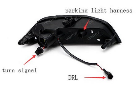

Step 4: Wire Your LED Turn Signal DRL Lights.
1. Plug the LED DRL’s turn signal plug into your stock turn signal harness. Twist-lock the connection to keep condensation from forming inside.
2. Connect the resistor decoder box onto the additional socket. Mount it onto a metal surface or let it hang.

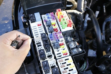

3. Connect the red wire to your car battery (+) and the black wire to a ground or your car battery (-).
4. Tap the yellow wire to your ACC 12V (+). The additional white wire is optional.
5. Tap the blue wire to your tail light (+) to enable the sequential flashing feature.
6. Pull out the incandescent parking light bulb from your stock parking light harness. You will not be using this harness. Plug the unused parking light harness into the opening on the back side and twist lock to keep condensation from forming inside.
