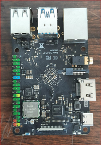

In this blog we are going to install the Grafana on Brainy Pi

Brainy Pi
Ethernet / Wifi
sd card
