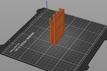

Step 1: Print the Case
I used gray PLA, no support needed.
Reference: Raspberry Pi 3b+ (3b plus) sleeve cover one-piece by icefox1983 July 04, 2018

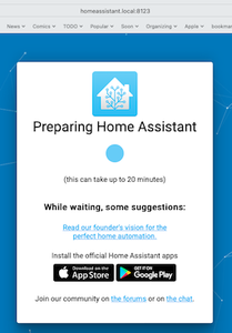

Step 6: Initial Configuration
Now, in a web browser you can go to http://homeassistant.local:8123 and you should see the blue-framed preparing screen.

You can click on the central pulsing blue dot to see an extended log of how far it has gotten.
  • Wait 20 minutes. (I only needed to wait 5 minutes).

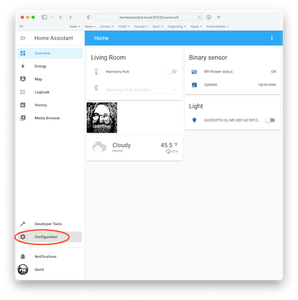

In the Home Assistant user interface, click on the Configuration link on the lower left.

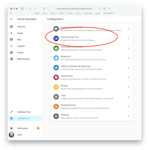

Step 9: Install the ZHA Driver for the Zigbee Dongle. Part 2
Click on Devices & Services

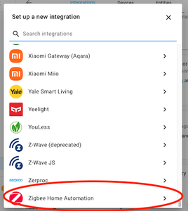

Step 11: Install the ZHA Driver for the Zigbee Dongle. Part 4
Scroll down and click on Zigbee Home Automation.
In the resulting alert, select the port that your zigbee device is connected to and click it submit dialog.

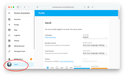

Step 12: Turn on Advanced Mode So You Can Install SSH. Part 1
Click on your name, at the bottom of the right column.

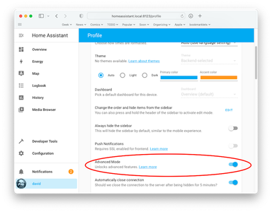

Step 13: Turn on Advanced Mode. Part 2
Scroll down and click to turn the Advanced Mode on/off control to on.

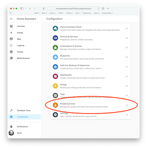

Step 14: Add Additional Users. Part 1
Click on the Configuration item in the left column, then click on People and Zones.
Step 15: Add Additional Users. Part 2
Click the + ADD PERSONS button on the lower right and set up accounts for additional people who will be using Home Assistant.

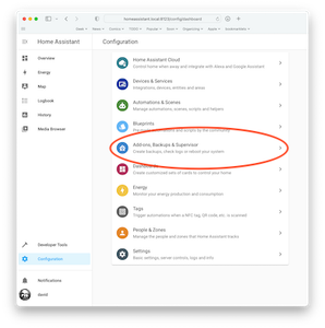

Step 16: Add Add Ons. Part 1
Click on the Configuration item in the left column, then click on Add-ons, Backups, & Supervisor

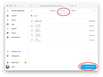

Step 18: Make a Backup File
Click on the Configuration item in the left column, then click on Add-ons, Backups, & Supervisor.
This time click on Backups, near the top of the window.
Clock on + CREATE BACKUP on the lower right, and give your backup a simple name, like today's date.

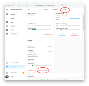

Step 19: First Power Down
This time click on Supervisor, near the top of the window.
Click on SHUTDOWN HOST
Wait 3 minutes, then unplug power from the Raspberry Pi.

Once, I tried all of the steps I’m recommending, but had the Pi hang at the Preparing stage and never progress to the Onboarding step. I just gave up for the day and tried the same steps again from the beginning the next day and it worked.
