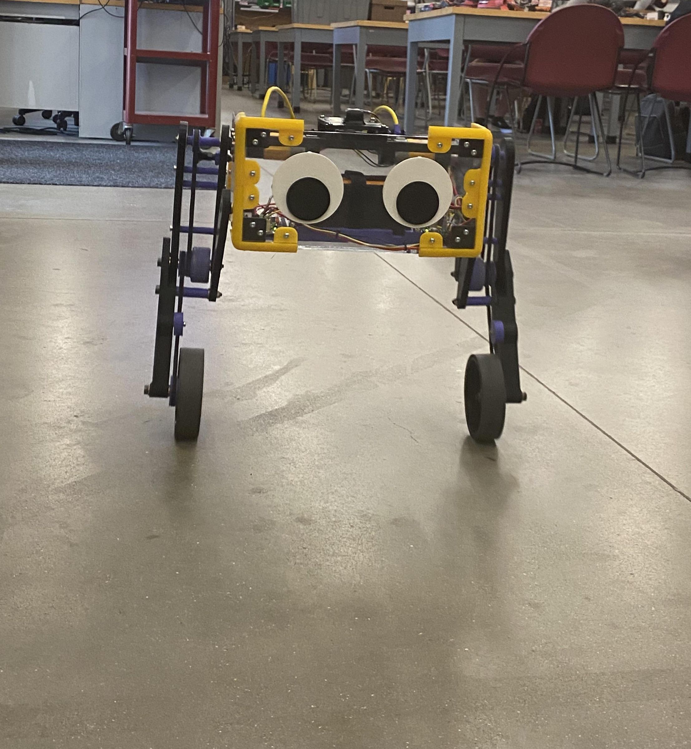

Introduction: Install ROS on Your Raspberry Pi 5 With ROCKO!
This instructable will walk you through how to
  1. Configure Ubuntu on a Rasperry Pi 5
  2. Set up ROS2 (Robot Operating System) on a Raspberry Pi 5
  3. Create a virtual environment to write Python code to ROS
  4. Configure your software environment for ROCKO, a self-balancing robot
These steps are meant to setup the ROCKO robotics platform. To learn more and build a ROCKO of your own, visit the ROCKO wiki or the full ROCKO instructable for more information.
