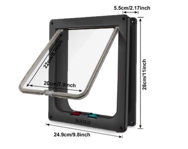

The first stage is to figure out the correct size of pet door that you need to buy, I looked up a few different sizes online and then made a cardboard stencil with a hole matching the various pet doors. I then got my dog to walk through the different stencils until I found the correct size. I then ordered the door I wanted.

Once your door arrives you need to make sure you position it correctly. The door will normally include instructions on this, but a basic way is to measure the height of your dog at its shoulder and then add an inch or two and that will be the height of the top of the opening.
My pet door came with a template to tape onto the door, I then traced around this with a pencil.

I did have one small issue, the timber on my door was a little thinner than the pet door was designed for. I could have trimmed the pet door down a little but instead chose to make a packer out of some spare plywood.
I repeated the process of cutting the hole out on a piece of plywood and added about an inch of clearance around this. I then painted the timber with primer. After drilling & countersinking some holes I screwed the packer to the wooden door.
