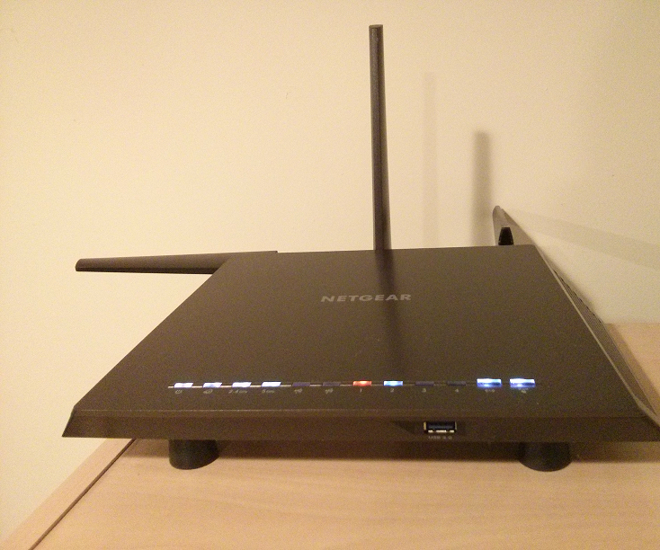

Materials:
  • NETGEAR R7000 Router
  • Ethernet cable
  • PC with Ethernet capability

Step 4: Upload the CHK DD-WRT File
Now, we'll upload the initial CHK DD-WRT firmware file to the router. CHK builds are specifically designed to upgrade from the stock factory firmware to DD-WRT.
  1. Navigate to Advanced > Administration > Router Update.
  2. Select the Browse button.
  3. In the file selection dialog box, select the CHK file you downloaded earlier, then select Open.
  4. Back on the Router Update page, select Upload.
  5. When asked to "Continue?", select OK.
  6. The file will begin uploading. Eventually, you will be prompted to login again. Login with the default credentials (username = admin, password = password).
  7. If you see a prompt "Warning! The firmware you are trying to upload is the same as the one you had.", just select Yes. Uploading will continue.
  8. When finished, the router will automatically reboot. Congratulations! You are now officially running DD-WRT.
