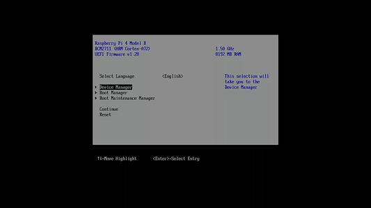

You need to be VERY careful for this step! As if you do it wrong you can fail the entire thing! Put the USB device, keyboard, mouse and the HDMI cable, when you boot it up, keep on clicking the 'esc' key, until you see the screen above, use the arrow keys to scroll down to Device Manager, then select Raspberry Pi Configuration, and select Advanced Configuration, scroll to 'Limit RAM to 3GB' and set it to 'Disabled' using the 'enter' key, press the 'f10' key to save and press 'esc' to leave and keep on pressing it to go to the first menu. scroll down to 'Continue' and it will direct you to a Raspberry Pi Logo,
