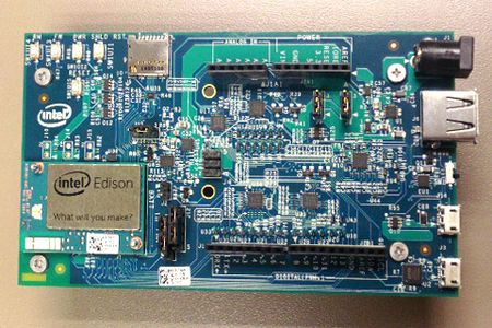

- (1) Intel Edison + Arduino breakout board

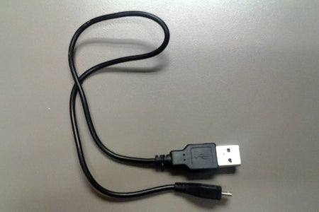

- (2) USB micro-B cables

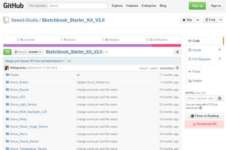

Step 1: Download the Library

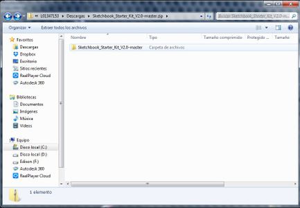

To install the Grove library follow this link to the github official web page: https://github.com/Seeed-Studio/Sketchbook_Starter_Kit_V2.0
Then in the right side click on "Download ZIP" button and the download will start automatically.

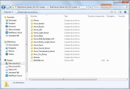

Step 2: Install Library
Locate the file, open it and navigate to the folders as showed in the images.
Copy the content of the folder to your Arduino folder (most of the cases under my documents folder).

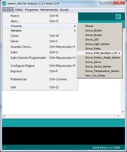

Step 3: Arduino IDE
Open your Arduino IDE, if it was open before you copied the files, then restart Arduino IDE.
Now under "File >> Sketches" you will see some examples for your Grove Starter Kit.

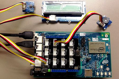

Step 4: Connecting

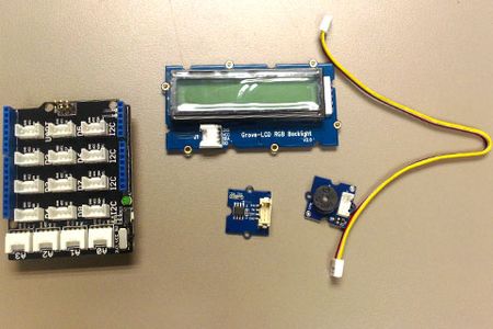

From your kit we will only use the followng items:
- Temperature sensor
- Buzzer
- RGB LCD
Connect as showed in the images. Temperature sensor is on “A0″, buzzer is on “D3″ and the RGB LCD could be connected in any “I2C” slot.
