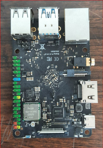

Introduction: Install Joomla on the Brainypi
About: First-year ECE undergrad || Learner || Hustler on the way to success
Hello, friends have you ever thought of making a personalized website for your business/content management/community/ non-profit organization, here there are possibilities that you will drop the idea of the website because you don't have time to learn to code, right? let's solve this problem together.
In these situations, we can use Joomla.
Joomla is a content management tool that allows users to create and maintain a web-based application or website using GUI operations without writing the codes. One of the most significant advantages of Joomla is its flexibility. You can use this software to manage numerous types of web content, from a traditional website to a discussion forum. It is very easy to install and setup Joomla.
You only require a few supplies to set up Joomla.
  1. Brainy Pi
  2. ethernet or Wi-Fi
  3. SD card/ hard drive

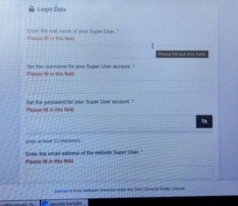

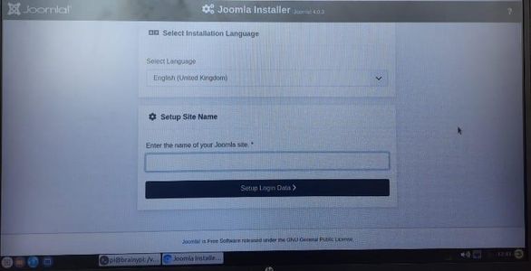

Step 7: Initial Setup
1. Start by typing in a name for your website in the textbox
Click on setup login data.
2. After this you have to fill Login data and then click on setup data

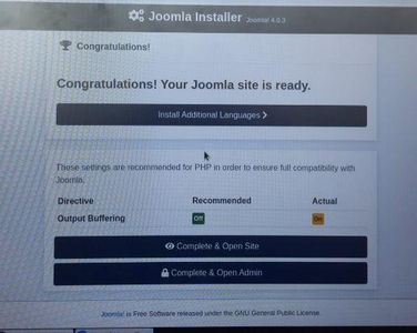

  • After checking Database configuration once you can click on Install joomla

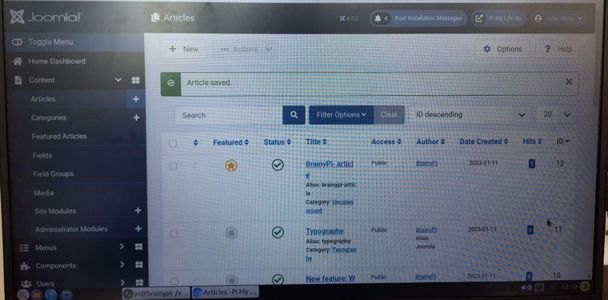

  • To go to the admin screen quickly, you can click the “Complete & Open Admin” button.
  • After this, you will be taken to the login window where you have login using super user account you just created
Step 8:

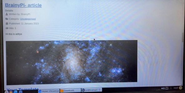

You now have access to the Joomla dashboard running on your Brainy Pi.
You can explore the entire dashboard and settings and you will automatically get to know how to use it as it is very simple and easy. you can use this dashboard to create and manage content on your website.
For example, I published sample article on my own personal website you can similarly put anything on your website you can personalize and add security layers on them.
