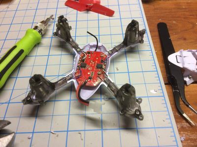

Step 2: Taking the Body Apart
Unscrew the props from the quadcopter. Next remove the bottom screws that hold on the bottom plate and motor guards.
Step 3: Removing the Motors
Take your soldering iron and remove the wires from the board that are connected to the motors. Next, remove the motors.
