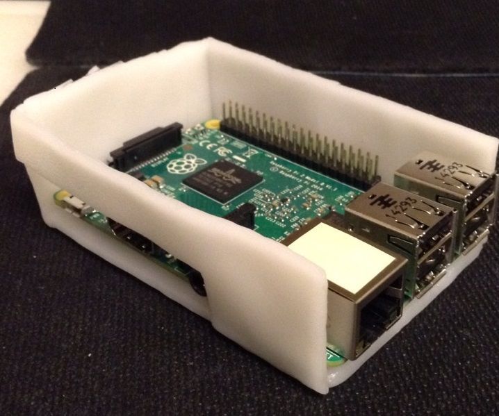

Introduction: Installing Windows Remote Desktop Server (RDP) on Your Raspberry Pi
Sometimes its not practical to have a monitor and keyboard attached to your Raspberry PI.
This is a quick guide to setting up your PI to allow windows to use Remote Desktop to connect to your PI
This guide is the result of the Bloominglabs Raspberry Pi and Adafruit Build Nights.
