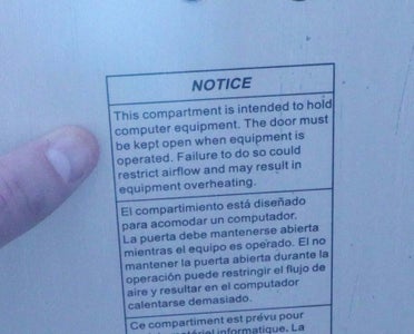

Most premade computer desks have a cabinet for the computer, which is little more than a poorly ventilated box. This is terrible for your computer, so most desk manufacturers tell you to leave the door open when the computer is in use. If you're like me, you probably have your computer on all day and you don't like the look with the door open. Adding a cabinet fan to exhaust the hot air from inside is a great solution to this problem, and it doesn't take much time at all.

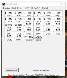

At this point, the installation is complete. Shown are two screenshots of the temperatures inside my PC, one at no load, and one after 30 minutes of gaming with the door closed. The PC components are hotter, as expected, but the inside of the case is cool, as is the exhaust air from the new fan. All in all, I'd say this is a success!
