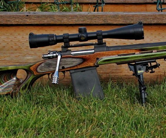

I recently picked up a new target rifle - a CZ 455 Elite .22LR - and while I like a lot about it, I just can't leave well enough alone. After a few sessions at the local range, one of the "glaring" shortcomings was the bolt handle. The stock bolt handle was a little short for my taste and the ball at the end of the handle was kind of slippery and small -so I decided to replace it with a bolt handle that better suits my preferences.

The first thing you need to do is make sure that the orientation you plan on installing the new handle isn't going to interfere with anything in either the closed or open position. Make sure you're going to have enough clearance around the bell of your scope (if your rifle is scoped) and that the handle won't hit the stock or interfere with your hand in the closed position. In my case, I found that if I just continued the line of the original bolt handle through the ball, that the angle would be about right all the way around.

The threaded hole in the bolt handle was a little deeper than my threaded stub, so I cut a piece of brass stock off to make a spacer that I slipped into the hole, and then threaded the handle on to the stub. A little fitting was required to get it to just the right length for this installation. Once it was going together the way I wanted it. I cleaned off the threads of the stub and the internal threads of the bolt handle with solvent, added blue loctite thread-locker, and snugged the new handle into place.
Enjoy your new bolt handle - I can say that on this rifle, it's a huge improvement.
(I also added a couple more bolt handles installed using the same technique - just to show that you're not limited to small rimfire rifles ;)
