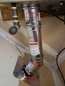

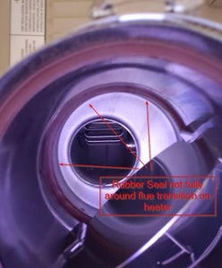

Step 8: Appendix 1: Z-flex Universal Adapter
The Z-flex Universal Adapter I used for this heater was technically not the correct one.
I had initially sent an email request to Mr. Heater, but due to delay I called and was told that the Universal Appliance Adapter (2ZVB04) would work - so I place my material order.
I then got the email response later and it contradicted the advisement saying that the appliance adapter will not work and I should instead order 2SVSRHA040, which appeared to be a pretty hard item to find (on back order a month out).
My order is already shipped and was planning to complete that weekend, so decided to proceed. After received the Z-flex the Universal Appliance Adapter (2ZVB04), I could see why I was later informed that it "wouldn't work" from Mr. Heater.
I'm attaching 2 photos:
1. Side profile showing depth alignment of the adapter and the flue transition on the heater. The raised ring on the adapter is where the red rubber gasket is housed. You can see that this overlaps only slightly on the short flue transition attached to the heater.
2. Looking inside the attached adapter to the heater. Here you can still see the red rubber gasket exposed because you can't fully push the adapter onto the transition. However, the main reason you can push it on further is because of the clamp screw that you can see towards the top of the 2nd photo (there is a clamp on both sides of the adapter).
I made 2ZVB04 work by removing the clamp from the heater side and push it on further until the rubber gasket was fully onto the flue transition. It is very tight fitting and does not move at all.
