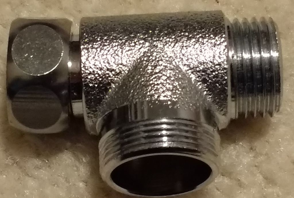

Next, grab your Sioux Chief 660-TK mini-rester. It would be great if they made a male ballcock to Female ballcock Tee connector that you could use for this project, but they don't. I tried contacting Sioux Chief about this but they never got back to me. So we're going to use the fitting and throw away the "mini-rester".
Now you may ask yourself, "Self, why am I buying this $20 part and then throwing away the most expensive part of it?" A fair question. The reality is you could probably make the plumbing connection another way, but other methods have disadvantages too. The reasons I am doing it this way is because-
1. Other methods which are cheaper require more skill or more tools than this method
2. This method can be easilly removed later (without tools!)
3. This method is less likely to leak since the number of connections is lower
4. Other methods are actually almost the same cost since there is no 1 "perfect" fitting for this project and several fittings are required.
First, unscrew the mini-rester from the fitting. You will need 2 wrenches. Be careful not to damage the threads or the plastic nut.
The mini-rester should have an O-ring on it. Remove the O-ring. A small flathead screwdriver might be helpful.
Put the O-ring onto the 3/8 in. x 1/2 in. Brass Flare x MIP Adapter (Watts A-184 or similar). Wrap the 3/8 Flare portion of this fitting with teflon tape (not shown).
Screw the 3/8" flare half of the fitting into the place where the mini-rester used to be.
This is the portion of the instructable that real plumbers probably won't like. The Mini-rester has straight threads so a 3/8" iron pipe nipple (3/8" MIP to 3/8" MIP) or 3/8" iron pipe adapter (3/8" MIP to 1/2" MIP) will not work. "Iron pipe" threads have tapered threads and won't fit. Only the 3/8" flare fitting will fit. Note- "Iron pipe" threads can (and often are) made of brass or bronze. Technically flare fittings should be used with other flare fittings, but in this case we are using the O-ring and the teflon tape to try to make sure it doesn't leak.
We have just made the fitting that we need. The water supply inlet is 7/8" ballcock male. The water outlet to the toilet tank is 7/8" ballcock female. The water outlet to the toilet seat is 1/2" male iron pipe [MIP]. Note that Iron Pipe thread is a type of thread, not a requirement that the fitting be made of iron.
