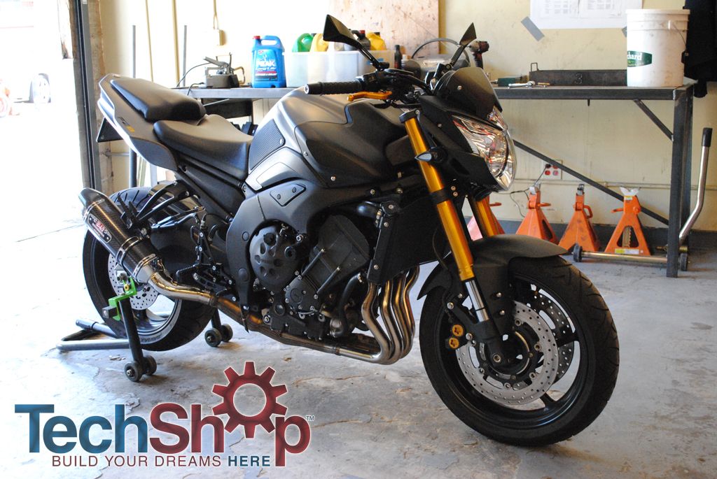

Introduction: Installing a Power Commander V on a Yamaha FZ8
About a month ago, I installed a Yoshimura R77-D slip on pipe for my bike. After installing it, I heard how great my bike sounded but realized that its performance is not being utilized. I decided to pick up a Power Commander V from Dynojet. This unit lets you gain control over fuel delivery and timing curves all in one easy to install unit. I will be taking my bike to the local dyno shop to see what gains in HP and torque my upgrades have given me. Typically, one should take their bike to a dyno when their bike is stock and going back each time a new performance upgrade is installed just to see your gains. This instructable will show you how to install a Power Commander V on your Fz8.

Step 8: Plug and Play
Now just install the supplied Dyno jet software and plug PCV box to the laptop via USB. The Dynojet website has maps readily available for download for each specific bike. Unfortunately, they did not have my setup available which is Yoshimura R77-D and K&N filter. So I decided to take bike to my local dyno shop to make me a custom map. Enjoy your newly tuned ride!!!
Step 9:
Just in case anyone was wondering about what my dyno chart looks like after install, here it is. Thats a gain of 4.54 hp and 2.01 lbs of torque.
