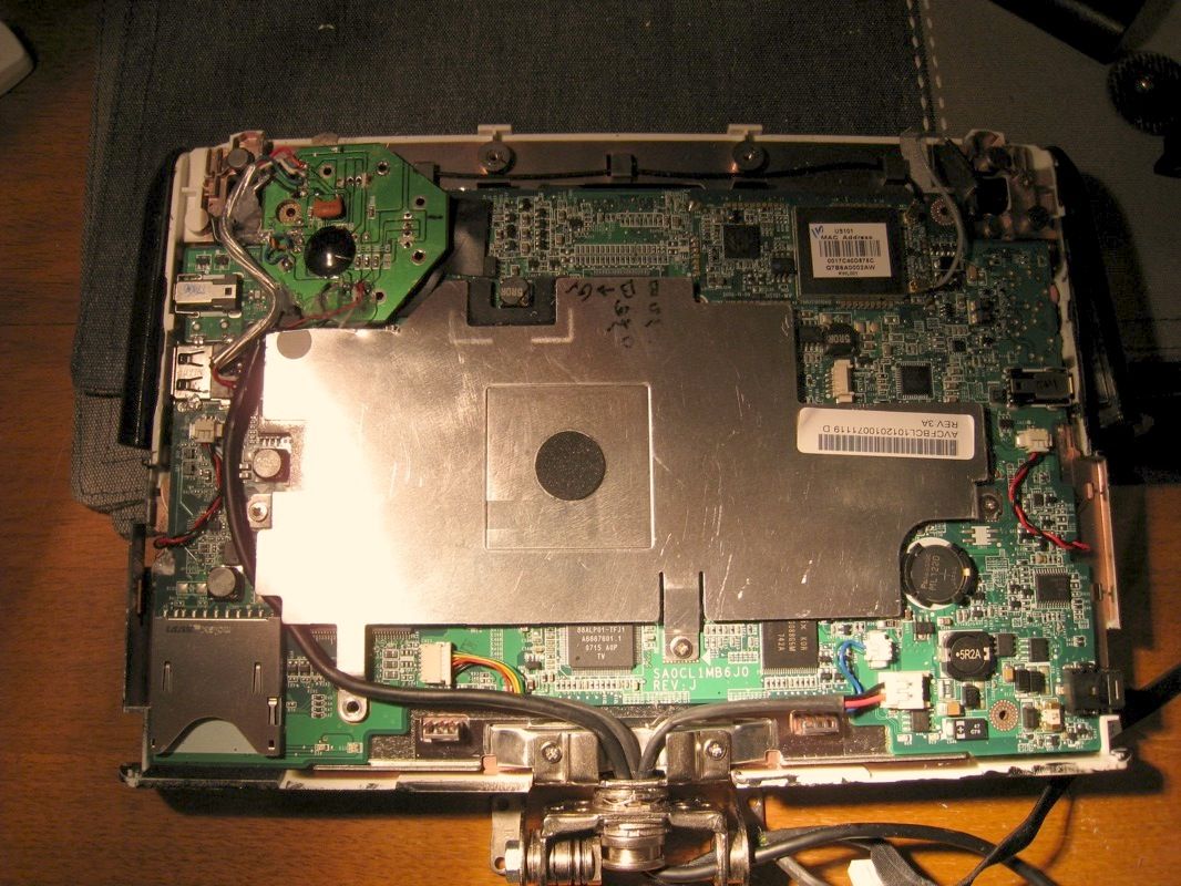

Assuming 1. and 2., you should be able to go to http://wiki.laptop.org/go/Disassembly and read the detailed and complete instructions on taking apart your XO. For Phase I of this project, you don't need to take the top half of your XO apart, just the keyboard part. When you're done getting everything apart, you'll have an XO "head" dangling two cables. The head will still works on AC power, as shown in the first photo, but the bottom part pretty much does nothing at this point.

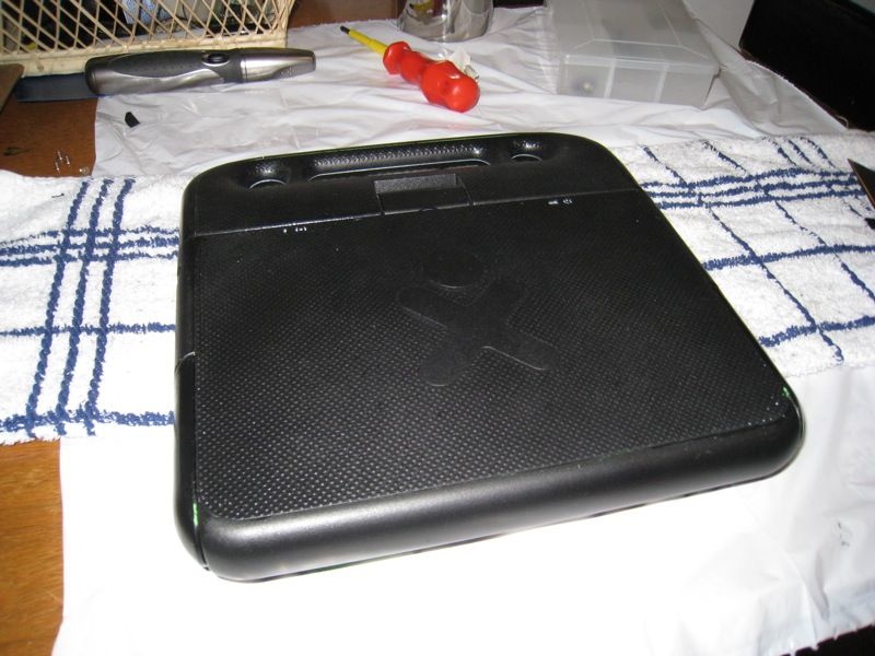

Assuming you didn't break any of your laptop parts trying to get it apart, this next step will be the first real damage to your XO. If you stop now and put your XO back together, your dog will not think less of you, but some of us primates might make hooting noises generally associated with derision. Go pet your dog, you'll feel better.
Make sure the original keyboard's ribbon cable is detached from its circuitboard, and here we go: work your fingernail (or pointy stick) under all three layers of the keyboard, then peel it back. It should come up in a single sheet, leaving only a sticky residue on the otherwise bare steel skeleton of your XO. I did mine while the bodiless head of my XO looked on in horror. Muahaha. Ha ha. Ha.

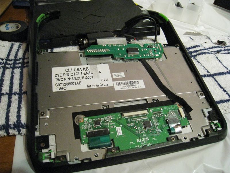

After you've gotten your new keyboard controller down to size, the really bad stuff starts happening to your XO. The controller card was plenty skinny to fit into the quarter-inch thick keyboard case you threw away in step 2, but the XO's base is amazingly (depressingly!) thin. Don't despair, just make another hole.
This time it's going to be a keyboard-controller-sized hole in the steel plate the keyboard's sitting on. The hole will offset some of the thickness of the controller so the XO's case will actually close again. Yay.
Align the card more or less with the ribbon cable, trace around it, then cut along the dotted line. Add an extra opening for the ribbon cable so it doesn't get crunched up against the card. I used four Dremel wheels cutting mine. Hopefully you can do better. Make sure you de-burr the edges, especially around the extra space you gave the cable, so any contact it has with the steel is nice and smooth. If you want to be extra safe, cap that steel with a piece of cello tape.
Dremel away the "ribs" running along the inside of the case opposite the controller card, so that the card will have a little more room on that side, too.
Run the USB cable up and out of the case, following the trackpad controller cable, and stick everything back into place. I used plenty of cello tape. Isn't it lovely? Luckily nobody will ever see this again.

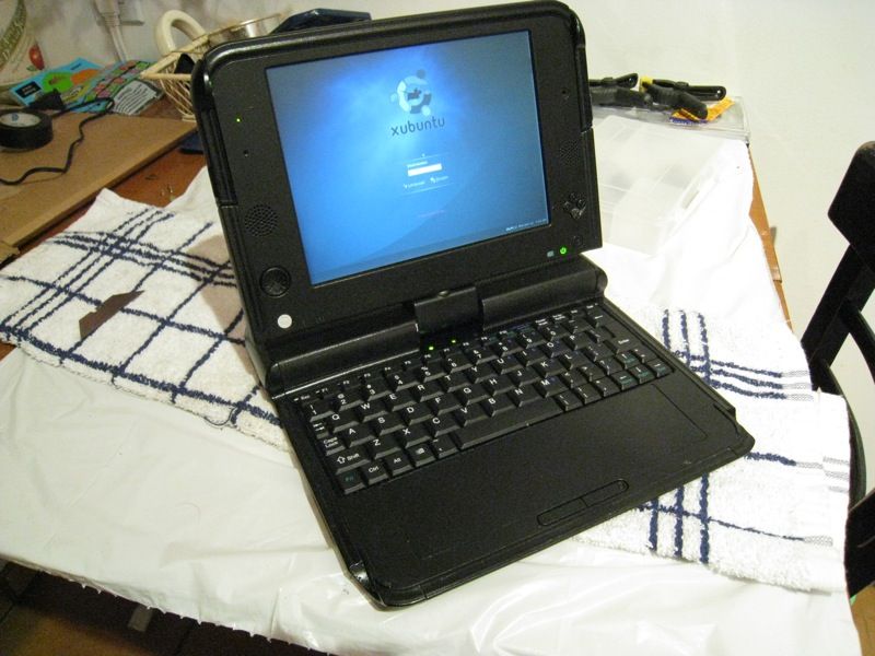

Take the USB cable hanging out of the hinge of your XO and plug it into, well, your XO. Of course, you could also plug it into your friend's computer and pretend you don't know anything about the four-letter words appearing on his or her screen, and for crying out loud why can't he/she just let you work on your laptop in peace?
That's it for now. When I get a chance I'll try taking this to the next logical step; phase II will include running the USB cable into the head of the XO and connecting it to one of the USB ports directly.
