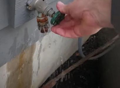

Adding the inside shut off Valve for the outside water to allow fixing spickets

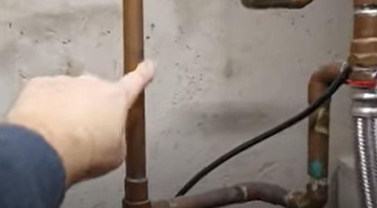

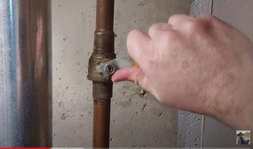

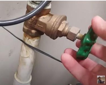

Step 1: Find a Place to Add the Valve
This needs to be where you will not lose water inside the house when the valve is off.
Please watch the video on You Tube it helps support our Instructions and how to's

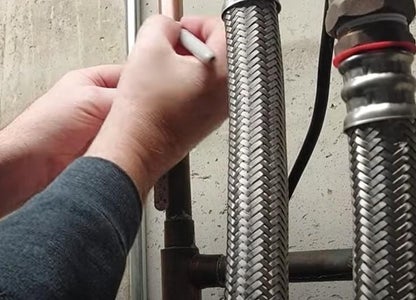

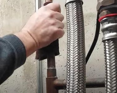

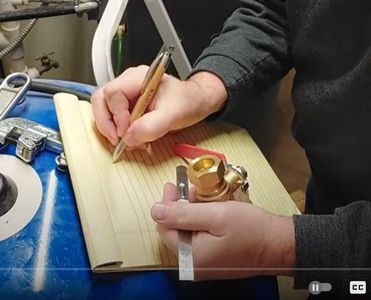

Measure Valve, Clean Pipe

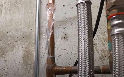

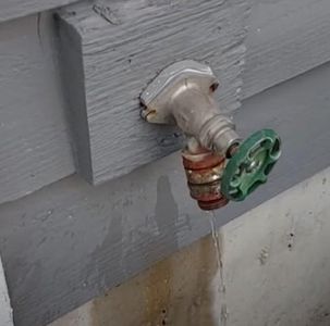

Step 2: Layout and Drain Pipe
Every Hose is different
You need to open two places to drain pipes quickly

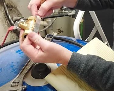

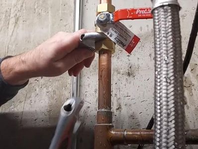

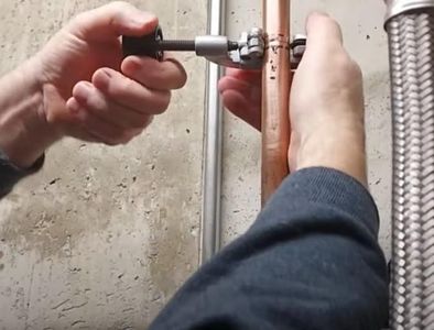

Step 3: Cut Pipe and Add Valve
Expect water to leak, this is a two story house so lots of water

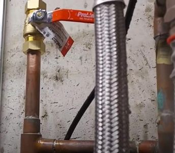

Install Valve see video
Close any open valve from the draining process
SLOWLY open the closed valve

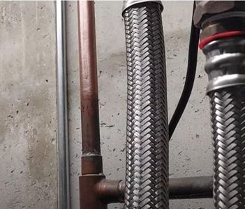

Check for leaks
Step 4: Test the System
