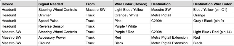

Step 1: Wire Up Vehicle Harness to Radio Harness
Connect all the obvious interconnects between the Metra 70-1771 harness and the Kenwood harness. These colors match one-to-one for everything present on the vehicle harness. With the exception of the Hot in Accessory/Run and Ground wires (see below), every other wire should splice one-to-one between the two harnesses. I suggest cutting the length to all be roughly the same as the other wires on the respective harness so that your completed adapter is less of a mess once completed.
The RED (Hot in Accessory/Run) and BLACK (Ground) wires I suggest including two additional wires in each connection:
- The respective red or black wire from the Maestro SW. This will supply the SW with power when the truck is running.
- A 12" lead of red or black wire of at least 18 gauge. This will be used for future expansion off the radio circuit, starting with any cameras that you add during this install.
Also, the Maestro SW "output wire" (pin C1, Blue / Yellow) should be connected to the Light Blue / Yellow wire on the Kenwood Harness.

Connect the franken-harness you made on the bench in the above step to the 16-pin female connector from the OE head unit. Then cross-connect the following wires using T-Taps to existing wiring in the truck:
- Steering Wheel Input from Vehicle. Maestro SW Purple/Red wire to truck connector C290b, pin 14 (Light Blue / Red).
- Speed Pulse. Kenwood Harness Pink wire to truck connector C290b, pin 9 (Gray / Black).
- Reverse Indicator. Kenwood Harness Purple / White wire to truck connector C270f, pin 1 (Black / Pink).
These connectors may be different for your truck, and different across model years, but for the 2005 MY (at least) they work. C290b is the 20-pin connector that was also connected to the back of the OE head unit. C270f is the connector in the bottom right corner of the Central Junction Box (aka Fuse Panel) when facing it under the dash.
