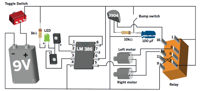

Step 6: Wire It Up!
I generally build the classic "herbie" junkbot variation by Wilf Rigter, but with CDS cells and the "power/balance" LED wired directly as a power indicator.
So get out the soldering iron and do it!
"Lumpybot" will get wired up in the next few weeks; I'll post photos then.
