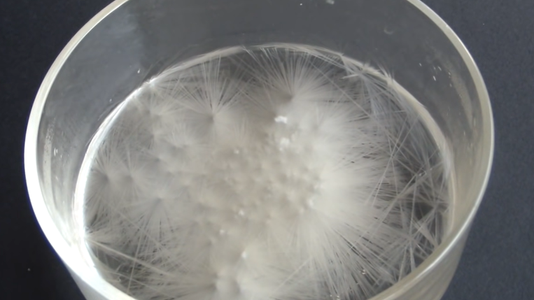

Then we took the glass vial and slowly passed through the sodium acetate. It had to be done very carefully, as it was very hot. We cover it with a piece of aluminum foil and put it in the freezer for about 1 hour. But during this time we observed how the liquid was acquiring a less liquid and more dense texture. We were able to see how some small crystals had formed in the bottom and on the sides of the saucepan.
After the time has elapsed, we remove the glass container from the freezer and uncover it.
It is then that we put an object inside the jar, in this case a spoon, and we observed that in seconds the liquid began to crystallize, until it did so completely. Was it really ice? Ice that was forming in a few seconds? What we have actually seen is a process of crystallization of sodium acetate, not ice, although its physical appearance does seem so. This occurs because this state in which the sodium acetate is found is unstable, therefore any small disturbance, such as introducing the spoon, causes crystallization to occur.
If we touch the container with our hands, we notice that it has warmed up a bit, since energy is released in the form of heat in this crystallization process.
