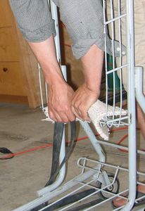

Step 2: Deburr It
Grind off the sharp burrs you made when you cut off the basket.
I left a little bit of the basket part attached. You'll see why in the next step.
Step 3: Reshape the Bottom End Rest
Bash on it until it's shaped like this.
Remove the baby seat back wall of the shopping cart.
Step 4: Pad the Bottom End Rest
Wrap it with a carpet scrap and wrap that with a bicycle innertube to hold it on.
Step 5: Dolly Away
Hook your motor's clamp over the push handle and use innertubes to secure all the dangling cables and stuff.
I innertubed the clamp over the push handle cuz I was in a hurry. If I had more time I'd bolt a board to the push handle and clamp the motor to that.
