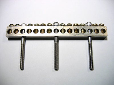

Step 1: The Grounding Bar
The grounding bar is an item used by electricians to ground house circuit wires. It comes in a variety of lengths and can be found in the electrical section of most local hardware stores or builder/contractor supply centers.
The bar shown is about 4 1/2 inches long and 1/2 inch in width.
The 3 empty slots are drilled all the way through, this is where fasteners can be used to attach the bar to something.

Step 2: Fasten the Grounding Bar to a Surface
All you need to do is make 3 holes with a hand drill into the surface you want to become the body of the instrument.
The screws shown in the photo are hex head 10-32 machine screws. They are used in the thumb piano shown in Step 9 by using a tap to thread the holes. Otherwise, these need washers and nuts to tighten for anchoring the grounding bar, or instead of washers, some kind of plate for the nut to press against. Smaller and different types of machine screws could be used adding washers and maybe lock washers as needed.

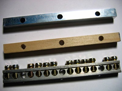

Step 3: Shims Might Be Necessary
The tines need room to vibrate, so depending on the type of surface chosen and the way the bar is mounted, it may be necessary to lift the grounding bar up off the instrument body using a shim. This just requires 3 more holes using the grounding bar as template.
The photo shows a steel bar and a wood square dowel for shims. Plastic, clay, bondo, rock hard water putty or other materials could be used.
The shims in the photo are trimmed and clean but they could be made of scraps, rough and irregular of edge, as long as the thickness is consistent.

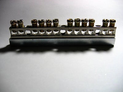

Step 4: The Grounding Bar Open on a Shim
The grounding bar provides a set screw method to hold tines.
The photo shows the bar on a shim with the screw slots opened.
You need a regular flat blade standard tip screwdriver or a driver with a Robertson bit.

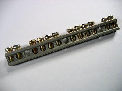

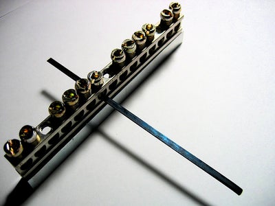

Step 5: Adding a Tine
Inserting a tine.
The tine can be anything that will vibrate and can fit the hole.
This photo shows a blue tempered spring steel tine.
Crank the screw down tight to anchor the tine.
This grounding bar can hold 12 tines.

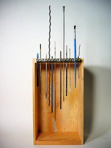

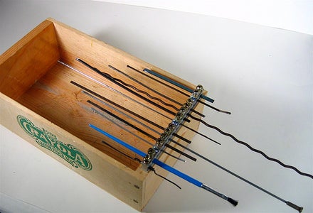

Step 6: Body and Tine
The grounding bar mounted on a small wood crate from a thrift store.
This demonstrates what is great about this method - you can use tines with a variety of shapes, sizes and materials at the same time.
Tines shown in the photo below the video from left to right:
hairpin
street sweeper bristle
unknown steel lattice debris
electrician's snake
knitting needle
bicycle spoke
spring steel
umbrella rib
plastic hobby/craft brush
plain steel wire - the end splayed by hammering
There is a video of this thumb piano being played.
Very roughly tuned and I used a guitar tuner pickup to run signal into a delay and guitar amp. Normally I would put the pickup closer to the bar but I was using a rubber band to hold it in place so where I placed it suited the size of the rubber band. The audio is just what the little point & shoot camera microphone was able to catch.

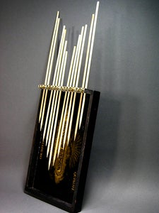

Step 8: Cigar Box Lid
The inside of a cigar box lid can provide a shallow receptacle that fits well in the hands. Again, no shim necessary.
The tines shown in the photo are bamboo teriyaki skewers.

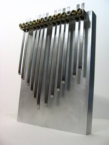

This is an example of the grounding bar used on unusual materials but in a conventional way.
The tines are spring steel and uniform across the span.
The body is aluminum, a 3/4 inch thick block, and there is an aluminum shim.
I wanted to make something sleek that looks machined but I really just used a cheap, much abused drill press. I used a tap to thread the anchor screw holes, putting the tap in the drill press and turning the chuck by hand.
Surprisingly, the thing is so heavy that a hollow door on sawhorses makes a good resonator for the instrument.

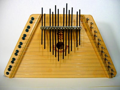

Here is a conceptual conglomerate.
The photo near the bottom of the page shows a zither from a thrift store mounted with the grounding bar kalimba which holds uniform spring steel tines. The bar is sitting on a steel shim and the tines are slightly bent to get above the zither strings.
Example of instrument using plastic swizzle sticks for tines
